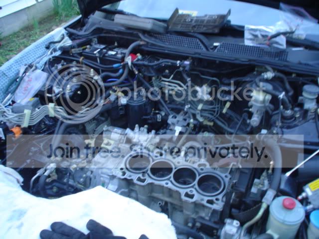

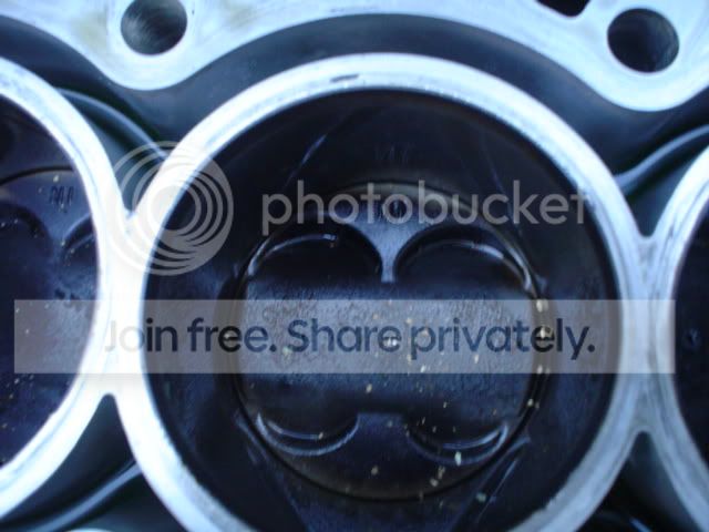

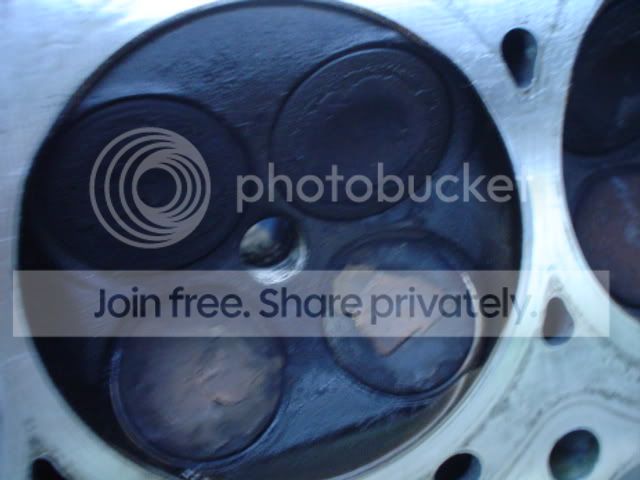

UPDATE:
noticed a very bad miss a couple of days ago did the usual plugs wires cap rotor ect. and nothing helped. the plugs were pitch black in 1 day except for #3 which looked just terrible. cant really describe what i was looking at because im not that great with plugs. my oil that i just changed yesterday was pitch black. So my car has been running wayyyyyy toooo rich on the kenji p28. excessive carbon buildup on all of the exhaust ports. #3 being the worst. there was oil on top of the piston when i took the head off of it. and you can see the crap caked on the valves. i think it has a cracked ring land won't know until tomorrow when i get the block out and to the machine shop. the head is going to have to be freshened up a bit now, and im going to need hondata to tune my new setup because this crappy computer just isnt cutting it. Pretty much my budget build of $1800 just turned into roughly 3k after a tune. Say bye to he supercharger for now hopefully by the end of summer ill have enough saved to get it. Ill keep you guys updated.

just a question: are you going to leave the block in there? or eventually take it out
Old Apr 24, 2006 | 02:08 AM
CRXtacy2006's Avatar
Posts: 235
From: Williamsburg, VA, US
we only had 2 hours of light after i started. taking the suspension, tranny, and block out today. to go to the machine shop.
