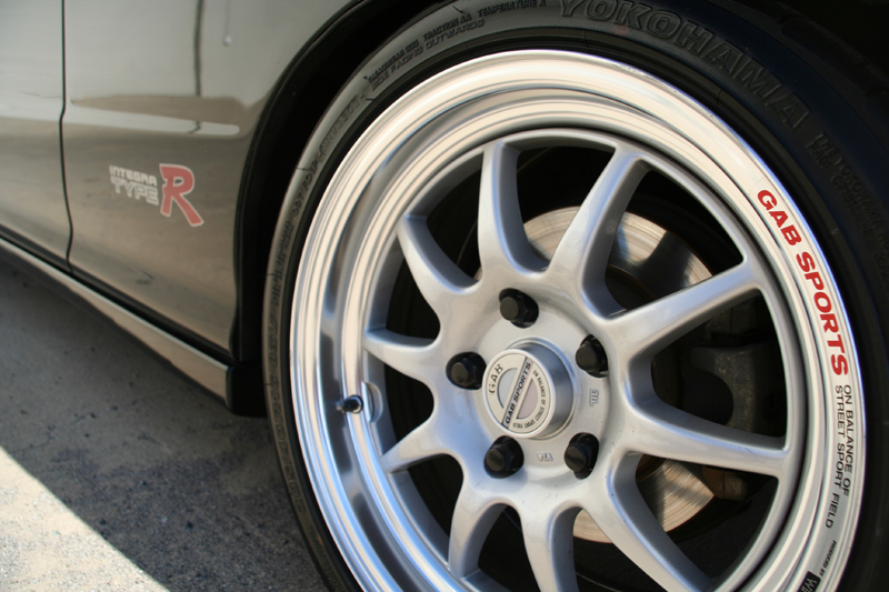

i'm thinkin about buying some wheels..but the offset of +32 is concerning me...
i'm lowered around 2.5"s...i'm worried bout rubbing issues...
can i put those wheels on without raising my car??? i dont wanna RUBBB!!

I used to have 32+ offset on my dc. It works perfect.
AS LONG AS YOU HAVE 40 SERIES TIRES. You will not experience any rubbing as long as you have a 40 series tire anything else and you will experience rubbing at close to full lock.
here is a picture of a 32 offset gab sports wheel on a dc2 type R as you can see he is lowered 2.5 if not more and he is using a 40 series tire.
Jeromy pm me if you want me to take the pics down
you might run into problems if you want to do a brake upgrade (i.e. spoon, endless)

That car looks like it would rub like hell during some spirited driving.

definitely, maybe a little more -camber to tuck those bad boys in a little more

what width wheel? that plays just as important of a role as offset....... a 15x7 with a +32 will stick out .25" farther than a 15x6.5......... so the width is also very important to know

those look like 16x7 gabs

I'm running 15x7 +35 on my civic, which is similar in regards to wheel clearance. I am not "slammed" I have maybe 2 finger gap in front and 3 in back, -2.5* camber in front, -1.5 in back. I had to fully roll the rear 1/4's in order for the car to even be lowered off the jack without hitting them.
Also, I'm using 205/50-15 rt615's, so they are wider and taller than a normal sized tire.
