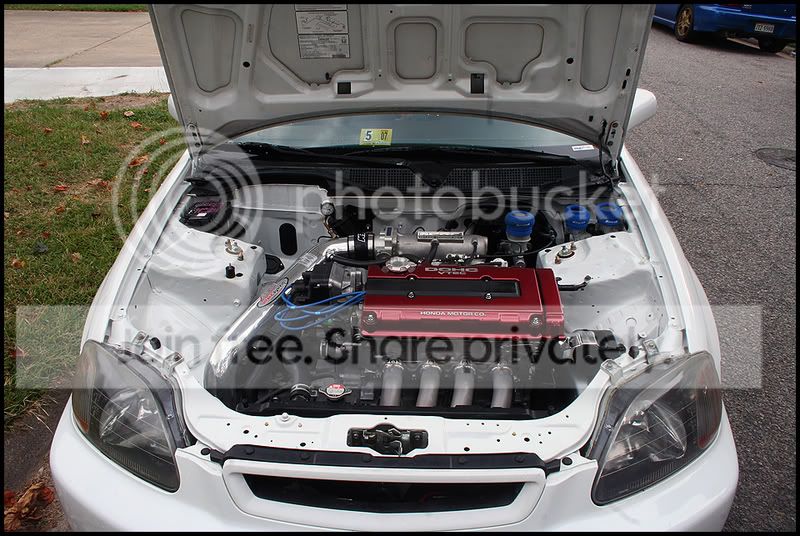

this is all i have but if you look at the top right or the right side you can kind of get a slight hint for now but ill get a better shot tomorrow
Old Apr 28, 2007 | 03:39 PM
slammedNslowLS's Avatar
Posts: 492
From: Mechanicsville, va, usa
and now that i look at it thats actually before i finished doing everything so like i said will def post another pic tomrrow since that doesnt help much
Old Apr 28, 2007 | 03:40 PM
Posts: 492
like the brackets you see on the left with the harness connected to and stuff are gone and all of that is tucked underneath the intake

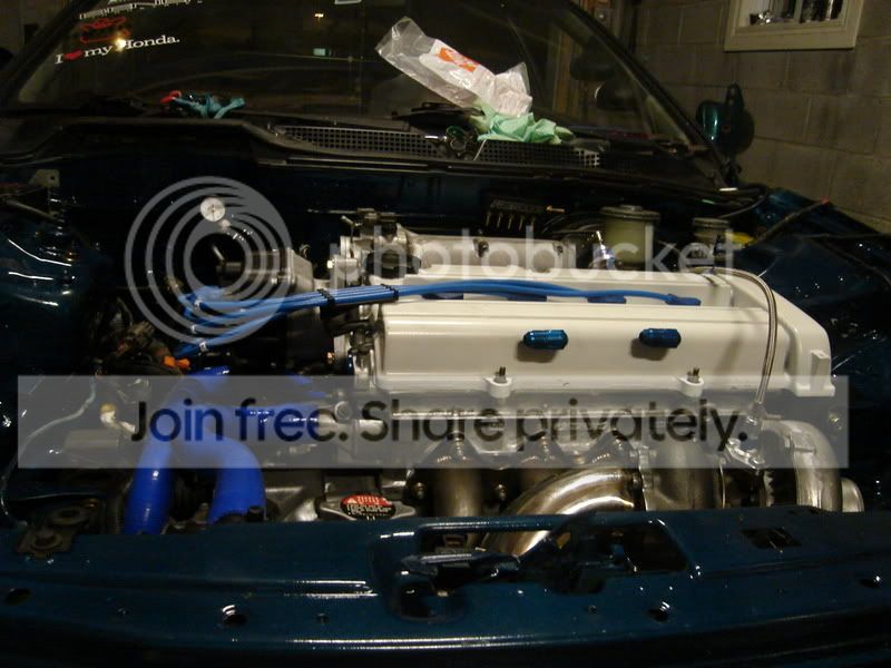

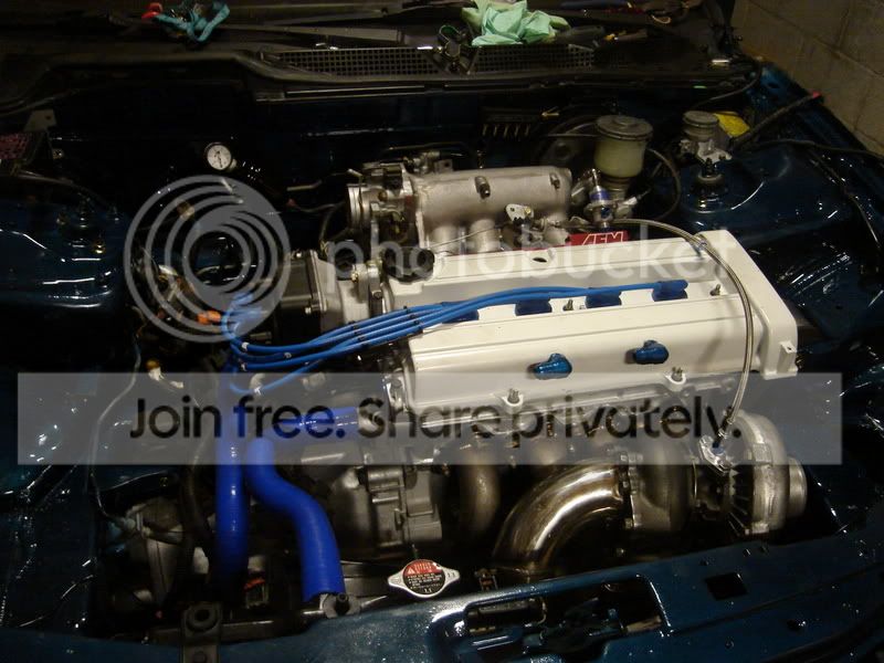

its dirty i know but there are the pics as of today. still cant do a lil more but that took an all of 15 min to do. and it lookis much better i think

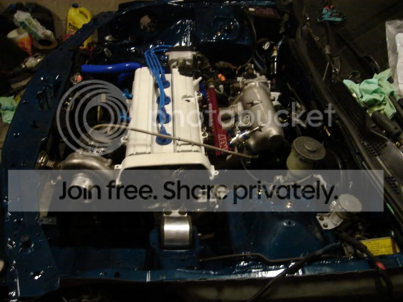

i just finished mine up, for the pass. side, i took off all the brackets, and just kinda ran them along the tranny above it, then for the driver's side, i extended the one headlight harness near the firewall, about 30 or so wires; in the pic where you see that gold battery terminal, i changed that out to a fuse block so the stock wireing harness and the one thick wire from the fuse box plugged right into it, then ran a thick gague wire to the back where the battery hides. i did leave the fuse box in tho. pics:
sorry for the dark pics, garage lighting sucks for taking pics. but i did pull the complete abs system, you can see how i ran the wires in the pic but it's covered up when the charge pipe is on; i just wanted everything off of the sides.
edit: if anyone is going to do something like this, please please please remember that motor grounds are important! i was wondering for like 3 hours why my car wasen't starting
Modified by Flexin5 at 1:18 AM 6/16/2007

why would you do all that work to tuck the wires and run the oil line for the turbo right over the valve cover. I know you need it but it looks riced out. I would try to run it around the side or something, not alot of options
Old Jun 15, 2007 | 04:23 PM
Flexin5's Avatar
Posts: 1,022
^because it was too tight for my liking to run it around the distributer side, and i diden't want it near the open cam gears on the other side; so over the valvecover was just fine.
