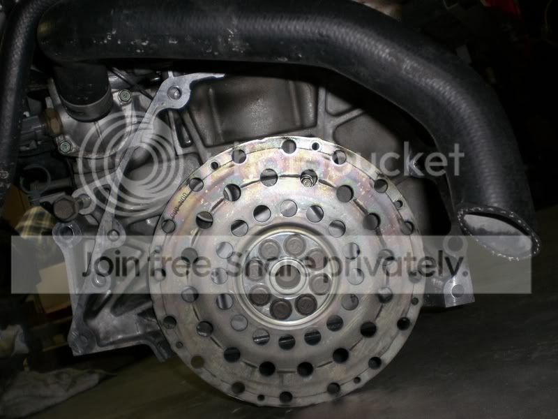

so i bought a motor from hmotors online. place is pretty cool. but what is this on my motor?
and how would my flywheel and clutch mount to it. or is just somethin hmotors puts on so the motor will sit somewat level?

I believe that is the drive plate from an automatic. Your flywheel should bolt right up after you remove it.
Just curious, is it a B20b?

flexplate is generally what its called.....basically what sam92 said though.

nah its a b18b.

It has "AT" all over the flexplate bolts....thats kinda funny.

Your gonna have to use the manual bolts from your old motor.

theres a difference in bolts between the autos and manals?

I'm pretty positive the manual bolts are longer to accomadate the thicker flywheel.

they all should, they're shorter than the manual's.

Yes, but why arent the MTs stamped MT and the autos just blank.....that is the real question .
