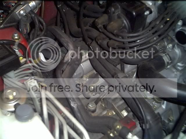

what are these small pipe lines? im wonderin because its been striped/deep grinds and it also did it to my intake
Old Dec 20, 2004 | 04:31 PM
04falcon's Avatar
Posts: 197
From: san diego, ca, usa
Default Re: underneath the intake.. (DynastyRacer22)
Looks like they are your ac lines.....

It is very common. Those are your AC lines and if you do no have your intake properly installed, it will mess them up.

They seem to be AC lines to me, they are the only ones that I can think of that are warped with foam. You might want to gently push and somewhat rebind them out of the way, so they will clear your intake better. Hope this helps.

same crap happend to me when i had my generic SRI installed. =\ Now my AC doesnt work obviously..

cheap intakes will do this almost no mater what.

I had the same problem, but i just wrapped electrical tape around them, and it stop rubbing a hole in the intake and the A/C lines.

yep i would suggest putting some black plastic electric cord wrap around the rubbing areas to protect the lines

I would just spend the money(if you have it), and get a nicer intake. If not, try and raise the intake up off of the lines. It doesn't need to be sitting on the lines like that at all. Even if you have them taped up.

put electrical tape over the exposed metal. when you reinstall your intake, put a wedge inbetween the intake and AC line then tighten the clamp. after, take the wedge out and you should have good clearance inbetween.

wire loom wont last very long. neither will black tape or foam. it gets hot in there. it vibrates alot.get a chunk of pure silicone heater hose. napa should sell it by the foot. split it with a razor knife. hose clamp it into place. it will last for the lifetime of the car.
