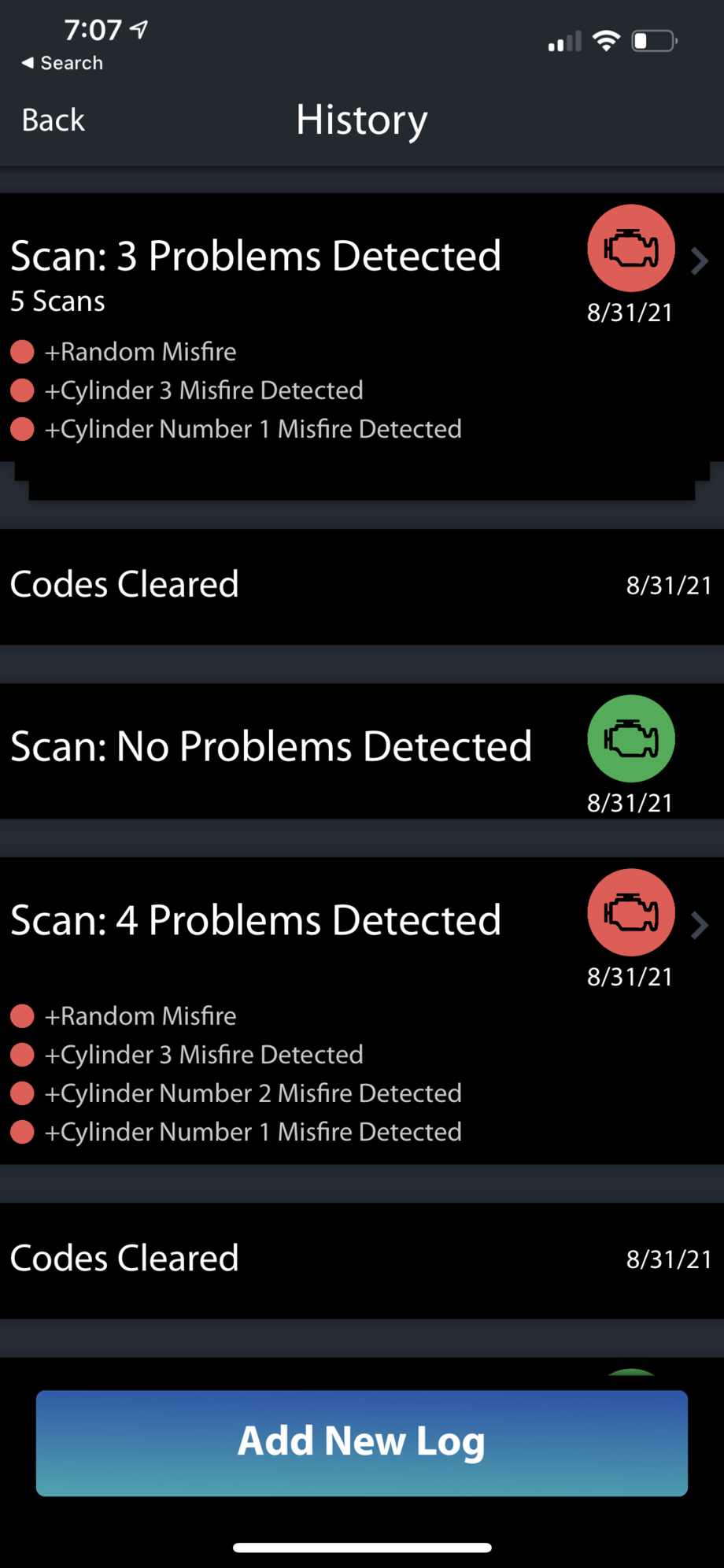

I have a 1996 Acura integra LS 4 door sedan 1.8 vtec with a yellow light and the codes below. I have since then changed,
1.spark plugs
2.wires
3.whole new distributor unit
3.compression test was all good 120 an up
4.new map sensor (fixed code)
5.cleaned throttle
6. new fuel injectors all 4
7.new fuel filter
8.oil change (might as well right)
9. will be cleaning the ecg valve tomorrow morning but then I’m lost again.
An ideas or recommendations is extremely appreciated and thank you for your time in advance.
I use to have to drive to get the codes back but the more Ive been fixing things here an there the faster they come back but at least they’re the same an not something new right. 🤣

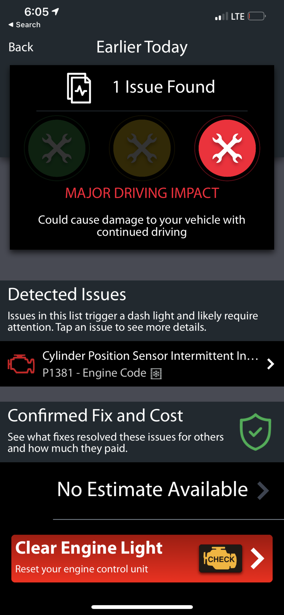

yeah I missed that last step I’m guessing that’s what caused this.
update to the last I did was the valve adjustment. I had to adjust all of them in the long run. 🤦‍♂️ I did however get rid of the engine light for awhile and the car was running really really good for about an hour an 30 straight but then as I was test driving and picking up my son from school I felt a very faint and small jolt like I missed the gas clutch combo, then the engine light came on with this…
I was only blocks away but I could automatically feel something and my car felt like it was dying. I felt sad inside driving it home. Is that strange? 🤔
