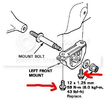

What size are those two bolts? Couldn't find anything in my helms.

the size is right there in the pic

<TABLE WIDTH="90%" CELLSPACING=0 CELLPADDING=0 ALIGN=CENTER><TR><TD>Quote, originally posted by thaiphob &raquo;</TD></TR><TR><TD CLASS="quote">the size is right there in the pic </TD></TR></TABLE>
No the size in that pic is the size of the nut on the end...

Doh! I found it in another section in the helms..
Its 10x1.25
Hopefully I can find something in that thread pitch that is short enough

10 or 13mm

<TABLE WIDTH="90%" CELLSPACING=0 CELLPADDING=0 ALIGN=CENTER><TR><TD>Quote, originally posted by 1337whp &raquo;</TD></TR><TR><TD CLASS="quote">10 or 13mm</TD></TR></TABLE>
haha that doesn't really tell anything. A bolt with a certain sized head can have any number of thread pitches. By the way the size of the head of these particular bolts is 14mm

According to acuraparts247.com the bolt is 10X30 which is millimeters. The 10 refers to the bolt's diameter and not the bolt's head size.

they are 10 milimeters. btw dont go to honda for them, i got like 20 of them for 4 box the other day. you can find them at metric stores

btw make sure they are 10by 1.25mm
