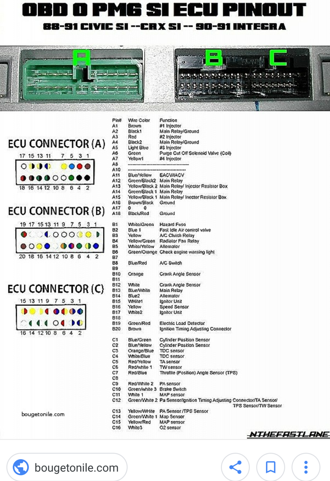

the main relay clicks like it's supposed to, and the ecm is brand new. I'm thinking it's not getting power, but I dont know which wire gives power to the ecm, and I haven't found any diagrams that say which wire does.

Idk how to post old threads yet but search in bar for (obdo pin out) by f20cmx from 3/18/11 might be able to find something or not. Depending if everything is a true 90 acura. Just try in to help.

Is this similar with your edu? I left the web page the pic is on. ni

I hate autocorrect smh. Can u see pic?

I can see the pic, but nowhere on it does it say power...

Ahhhh a code 0 is a bad ecu

check all your grounds
