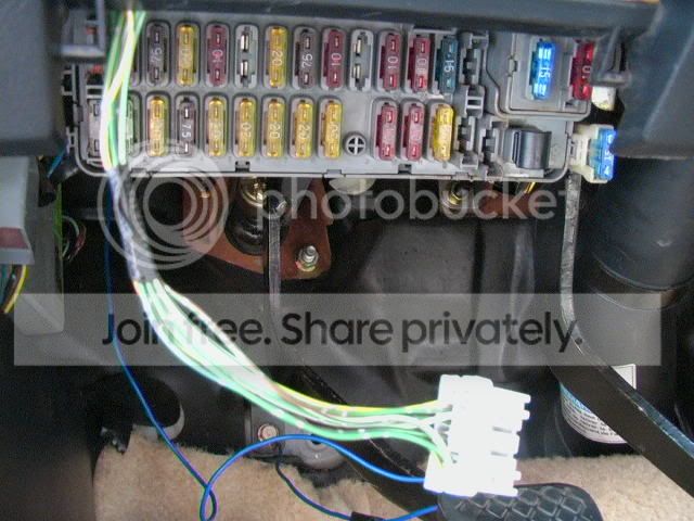

The other night my cluster lights went out.Just the rpm and mph ones. So i replaced them with brand new 194 bulbs and now still nothing. So i started feeling around under the fuse box andd i found thisIm guessing this is my problem. If these are the cluster wires,could any one tell me where to plug them in at?

Looks like it plugs into the fusebox. However, if a plug like that was removed, the whole cluster wouldn't work, not just the lights.

ok then whats that wire hanging there because thats means something isnt working..

IDK, you need a better picture of the wire

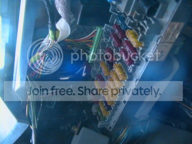

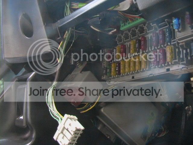

OK 3 pictures i took.Id appreciate as much help as i can get,because this MUST work before tomarrow night.

I bet that connector you see is the rear harness connector. Unbolt your fuse box and plug that wire back in and your tail lights should work again.

Yes, that white plug goes to the back of the fusebox or near the top edge. The blue wire, however, doesn't look OEM.

^ What they both said. It plugs into the back of the fuse box that you took a picture of. Get your head in there and take a look (it can be done) or use a mirror...or just feel around.
