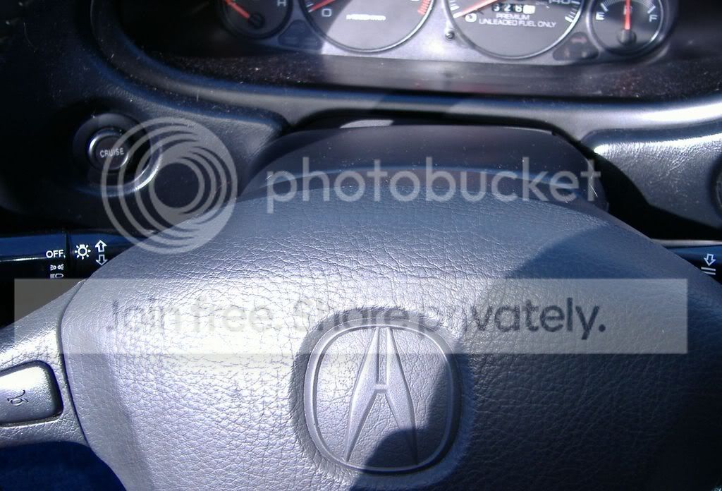

My entire steering wheel column is off to the left a bit, no idea why. How could I adjust this?

Heres the steerign wheel too, which is off and the airbag has been replaced for some unknown reason, cause the car has never been in an accident according to carfax and couldnt find anything while looking at the exterior.

did you just buy this car? It could have been in an accident even though the carfax was clean, it was just not reported. as far as adjusting it I truly dont know how. sorry.

got the car like 4 months ago, the guy at acura looked it over and said it had not been in an accident. it has aftermarket control arms and all that junk i dunno if you have to tamper with the steering wheel or whatever when you change that.

that whole shaft could be messed up somehow. at least see under there and look if everything is bolted up correctly...

no, the control arms wont have anything to do with the angle the steering wheel is at inside the cabin. remove the panel under the steering wheel, and dont forget the the little screw in the coin tray. and look around, make sure that everything looks right, but if the car doesnt drive wrong, and there is no issues with the steering (ie: shaking, groaning, tough to turn one way) then you may just have to live with it unless you replace the whole setup.

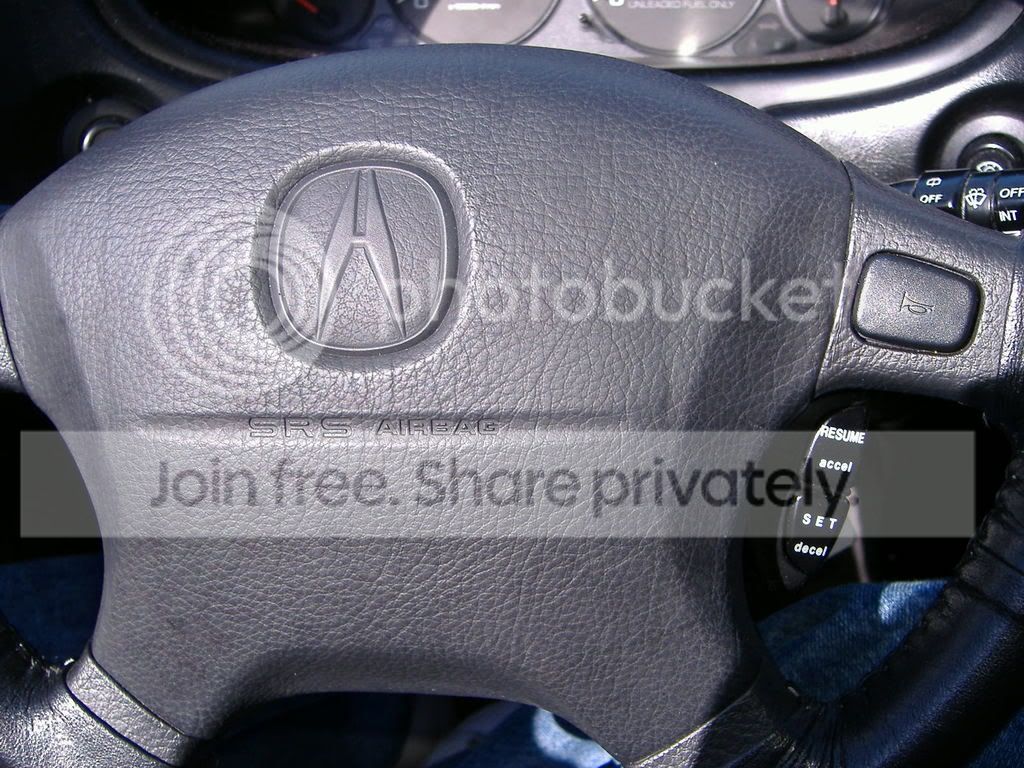

Damn. according to what u guys say mine WAS stolen before. mine does the same thing but dips toward the right. I'll try your advice and let you know if it works. FINALLY an answer! thanks
heres a pic
Old May 28, 2008 | 07:08 AM
jomama's Avatar
Posts: 3,979
From: Kansas City, MO, US
lol, mine's the same... dips to the left, i think i never thought much of it as i figured it was just the plastic thing.

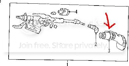

theres one bolt like right there, loosen it then crank the wheel the way you need the column to move. you must make sure that prior to that step you have turned off the car and clicked the steering wheel into the locking position.
if this does not work, there is a piece right under the plastic thing behind the steering wheel that can be adjusted. it is only like one or two bolts to do that im sure you guys can figure it out.
the first step should do the trick tho, thats what it was for me.
