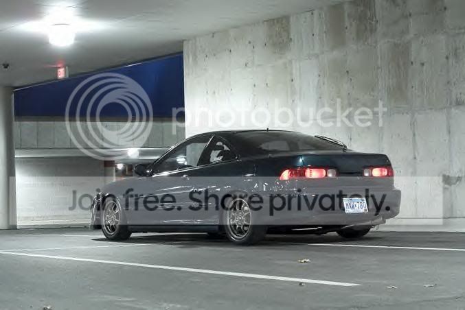

Vi3tboy's Avatar
Posts: 1,800
From: Twin Cities MN
go wingless and get it welded shut!
i love wingless dc's also

Clean car !!
I will eventually get it welded, but I will prolly plug them for now. So more info on where to buy the rubber plugs, I have seen many DC's with plugs so I know someone knows.
