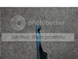

will a broken passenger side mount tab cause my front bumper to sag at all? will there be any problems with this? im getting a new bumper and it has a broken mount tab, just wanna know if id be waisting my time and money if i were to actually purchase this, thanks for the help!

looks like this... if it is going to be a problem could a body shop fix it? because im going to get some body work done, paint and touch up the bumper, remove my spoiler and stuff. please answer original question.

if thats the only tab i dont think it would cause any problems...i actually think that tab is broken on both sides of my bumper and mine looks fine

Use a large diameter washer. I had a Legend with all of the tabs broken and just put washers on it. You can gorilla glue them on if you're that worried.

any body shop can plastic weld it back together, its not a problem
