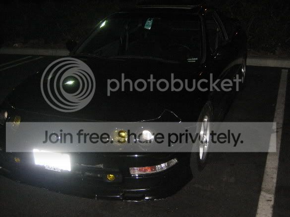

if you have the time do them yourself, it's really not that hard. and it's actually pretty fun and the end result is worth the effort, plus you could do a little custom work while you're at it... i did
