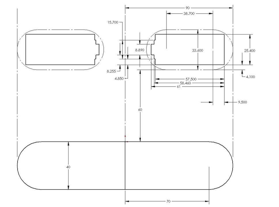

The sidemarker location in this DIY is not correct. The forward-most point on the sidemarker lens (the middle of the curved end of the lens) should line up vertically where the lower body crease intersects the wheel arch, and the top edge of the lens should be about 1/2"-3/4" down from the upper body line in the fender. This places the sidemarker in the correct OEM location.
The little notch at the end of the hole should also face towards the door.
This shows the correct location:
This is the hole size. This is the location template for EG fenders, but ignore the bottom part showing the fender moulding. Only use this for the hole size. DO NOT print this out and use this as the template, unless you print from something like photoshop. I do not believe this will print out actual size. You need to verify the dimensions (in millimeters) with a ruler. I actually drew this diagram on CAD software at work to make sure it printed out actual size.
This is based upon actual photos of a JDM fender with the sidemarker removed. non-USDM Integras with the same front end as USDM also had their side markers in the same location.
To install my side markers, I removed the fenders and made marks on the back side of the fender, then cut with metal nibblers from the front. It's easier to follow your marks with a metal nibbler if you have the nibbler handles on the opposite side of the fender from your marks. However if you mark on the front and then come through from the back with the nibbler, it can chip off some of the paint around the edges of the hole. It's better to make the marks on the back of the fender, tape over the front side of the fender, and came through from the front.
Yes, I have done this more than a few times to the different fenders that have been on my car.
