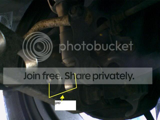

i recently bought control arms from a company called wicked tuning. I hooked iup the control arms and no my sway bar wont hook up to the arms there is a gap in between the arm and the bar.. i was wondering if anyone else had this problem and knew how to fix it thanks....

they have the same design as blox. take a picture so we can se what your talking about. do you mean that your links are to far from the hole to bolt down? ive seen pictures of them installed on a couple cars with sway bars and they semed to hook up fine

thanks for all your replies im gonna take a pic of it tomorrow and post em up

if they are similar to blox, then you should be able to get the bolt through the hole....only concern is if ur using stock endlinks, because it wont really be at a 90 degree angle..but it still works

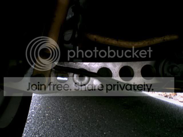

^^^ thats really off.
should have got a set of OEM type r LCA?
Old Jan 17, 2008 | 12:41 PM
goota's Avatar
Joined: Jun 2007
Posts: 507
From: 619
thats not an ITR sway bar. go look at home depot for something that will work as a spacer. 6061 aluminum should be fine.
Old Jan 18, 2008 | 06:28 AM
raiden571's Avatar
Posts: 931
From: cortland, ohio, usa
i personally would in vest in some new endlinks, but thats just my opinion. youll spend 10 -15 bux at most for some hardware to make it work or just buy a set of 30-40 dollar endlinks that bolt right on with out messing around.
Old Jan 18, 2008 | 07:18 AM
NH538DB8's Avatar
Posts: 122
yeah, I had the same problem. Adjustable endlinks make the world a better place. just make sure you put some loctite on the threads or they can and will come apart.
Old Jan 18, 2008 | 12:03 PM
StReCh4130's Avatar
Posts: 360
From: Bronx, New York, United States
Default Re: (NH538DB8)
I have a pair of Wicked LCA's on my car they, fit alright, I just put some screws and bolts I had lying around to fill the gap. I've had them on for about 10 months now with no problems. Hopefully you can find something that'll work for you.
