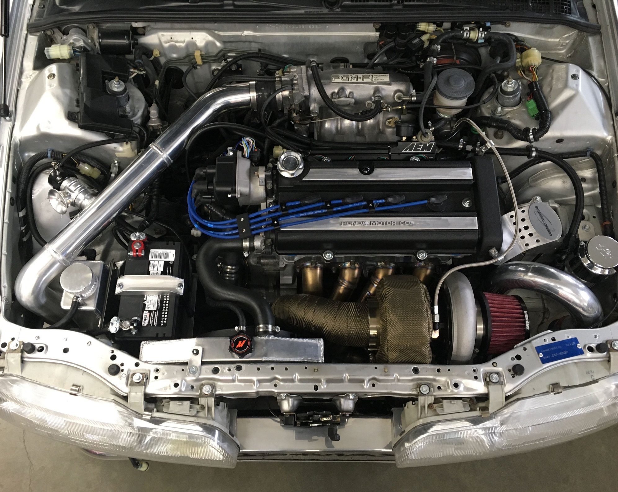

Hi can someone please help me out. I have a fully built b18 bored to a 2.0L I知 $30,000 into this build and I知 having a temp creeping issue. Car runs better now since I致e added a push fan on the front of my half Mishimoto rad. My intercooler is blocking the rad is why I added a push fan. my tablet via Bluetooth reads 196f but when under boost (7psi) the cluster gauge creeps up while the tablet stays at 196f but than goes back to normal while cruising. I dont have bubbles in my rad not any back full into the reservoir so I ruled out a head gasket. But I could be wrong. Any assistance would be very much appreciated.

Well,
- not using a full size radiator but I do see a dual core half size radiator which leads me to the next issue
- don't see a fan shroud (probably bad angle) so not all of the coolant is getting its temp dropped
It looks like you're not cooling your coolant fast enough. Get a thermo cam and get 2 readings from the thermostat housing and at the outlet of the lower radiator.
