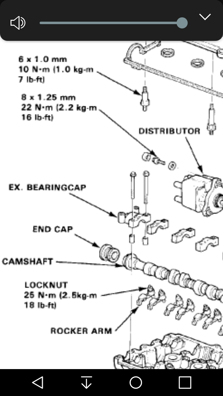

Sup fam, so long story short i replaced my cam shaft seal and the 2 bolts that hold down the bearing cap snapped off..is this the end of the world? Or its not a big deal?

The 2 bolts on The ex bearing cap snapped

If your lucky and it didn't snap clean off. Maybe you can take the cap off and vice grip it out. If not then have you or have someone extract it or drill it out.
Either way it'll eventually start leaking again if not taken care of.

Did you break the 2 under the valve cover? or outside of it? I think id be more concerned if the ones under the vc broke. It's not the end of the world but I'd still try to fix it.
Those little bolts should come out pretty easy. hopefully it snapped above the deck, it now if try a tiny punch before a reverse drill bit.

Yeah the ones under the valve cover both snapped at mid bolt so half of the bolt is still in the hole threaded mid way the hole if that makes sense? Im not lucky cuz they didnt snap at the head of the bolt. There deep in there. Thats why im concerned

Yeah there clean off but at mid bolt so the other half is still in the head deep in the whole. I have no clue how to remove it
