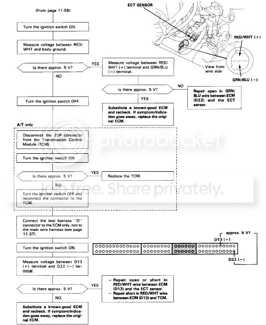

Old Sep 18, 2011 | 10:42 AM
HondaPartsHero's Avatar
Technical Hero
Joined: May 2002
Posts: 9,875
Likes: 35
From: Charlotte, NC, 28227
Default Re: NEED HELPP
Old Sep 18, 2011 | 11:15 AM
GagnarTheUnruly's Avatar
Joined: Sep 2009
Posts: 3,842
Likes: 6
From: Mountains
^^ damn that flow chart is way better than the one I have...

do i just the volt meter in the connector? what should all the wires read?
