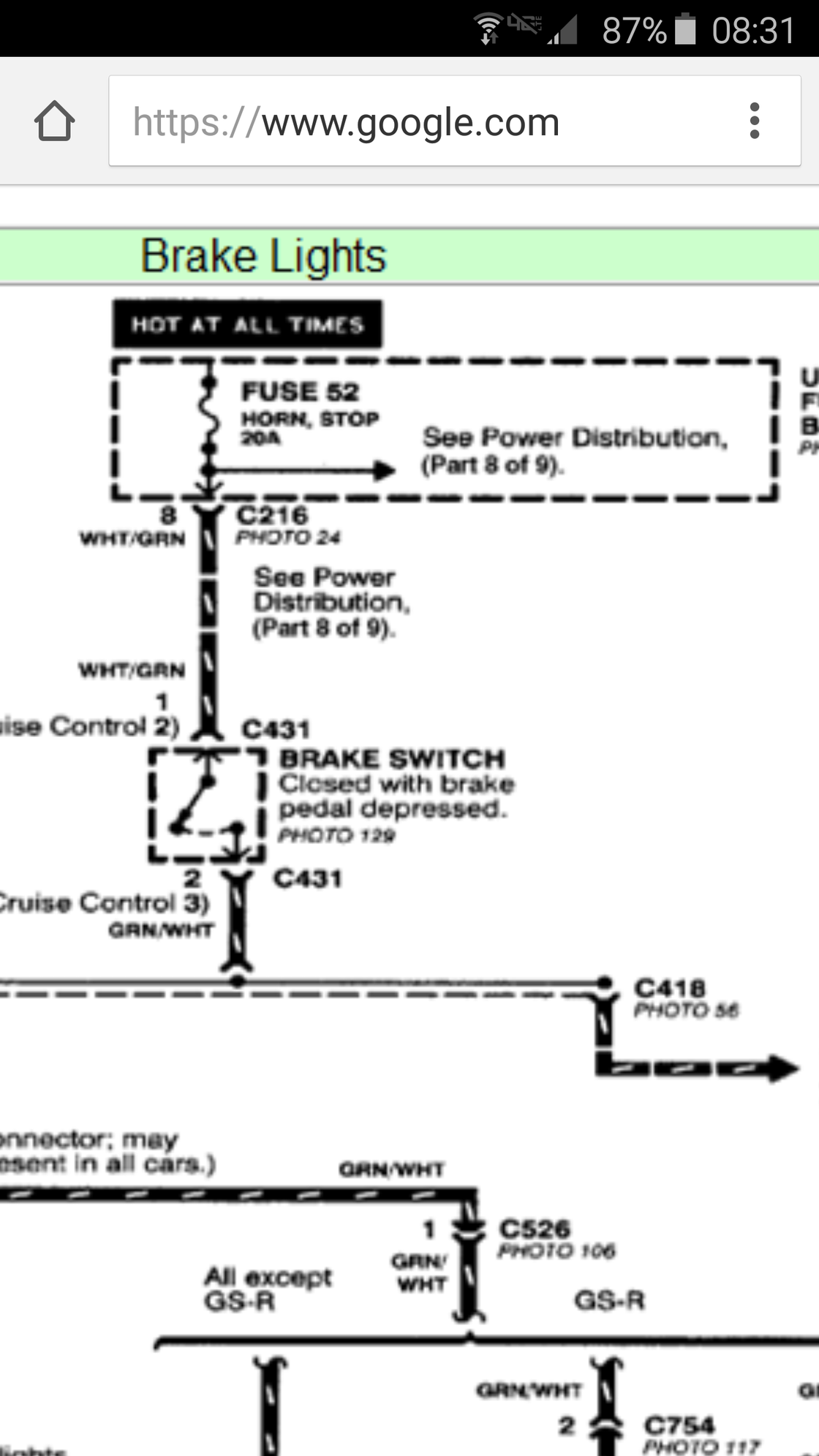

Can someone show me where connector c216 is. Car is a 95 integra. I know it's under the under hood fuse box but what connector is it

c216 = 9 pin plug, Grey colored connector
You cant miss it...There's only 4 plugs on the underside of the fuse box and only one has 9 pins.

I found it thanks tho
