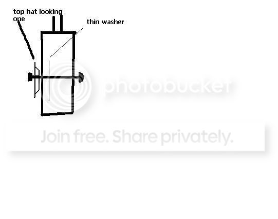

Default Re: Name this part (McGeeTM)
is this how it goes?
lol im so confused i went up under the car and neither one will fit in between that rod thing so do they each go on opposite sides with bolt going threw

Old Mar 20, 2007 | 06:44 PM
mcgee*'s Avatar
Cigarette Squad
Posts: 2,914
From: Columbia, SC
is this right? ignore the crookedness of the silver washer
Old Mar 20, 2007 | 06:53 PM
90civSi's Avatar
Posts: 368
From: Ohio, US
no, take then and they go on the transmission side.
if you are laying under the car, it will go on the linkage to the left thin one on first, then the linkage, then the cupped one.
hope that helps

Default Re: Name this part (90civSi)
picture was taken of me laying head in from drivers side so its on the side of the driver
and so that big one chills by itself? it doesnt go with the cup thing like i have it because then it seems like it sags
Your at the wrong end, those washers go on the tranny end of the bar!
Do yourself a favor and buy a $15 Haynes manual. We have been telling you that it bolts into the tranny, you are at the shifter.
ok what i did was put the flat washer on the transmission part then put the rod thing on followed by hat thing going toward to rod followed by screwing it in. is this right?
i checked my shifter still moved side to side like jelly
would that broken boot below the shifter itself cause that..it seems ript pretty bad

Default Re: (McGeeTM)
found the problem the bitch pin was removed and i put a bolt there because i tore apart that bitch.
