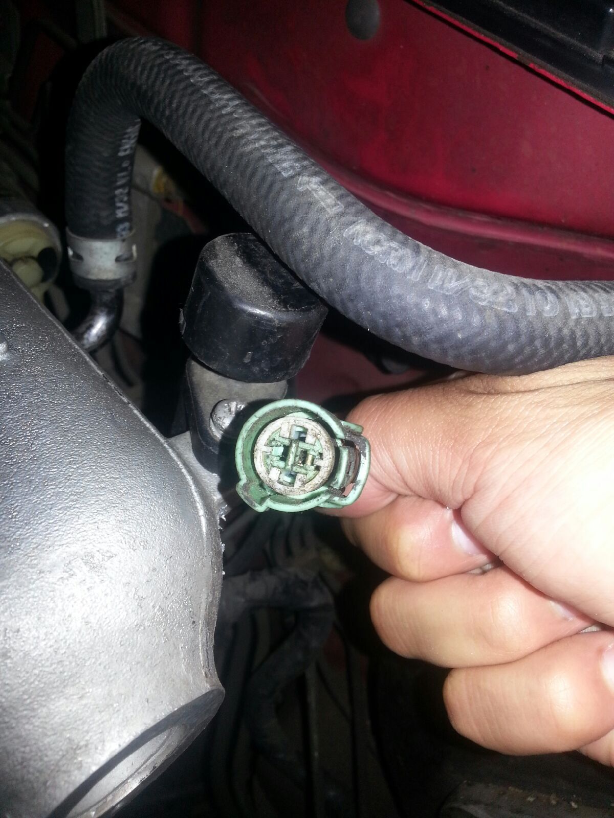

That is probably for the power steering pressure Switch. The knock sensor one is generally gray and only has one wire (pink/ blue stripe)

Ok thank you and is it this one?

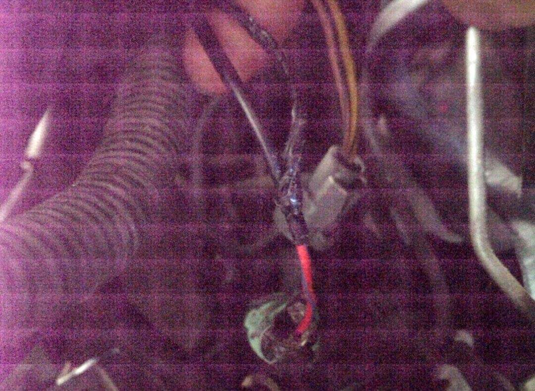

OK thanks but the wire is tapped with other wires. Let me send you a picture

Sorry about the **** quality but why is it tapped there? And its not long enough if maybe i cut the tape

Taped or tapped? If its just taped with electrical tape then cut some of the tape back. If its tapped with another wire then it should definitely not be.

Then which one is the knock sensor plug??????

Get some better pics of the splice in the wire, is it just taped to another wire or is the wire tapped into another wire? did you try pluging it in and clearing the code to see if it comes back??
