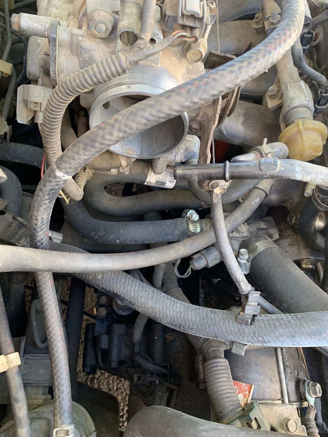

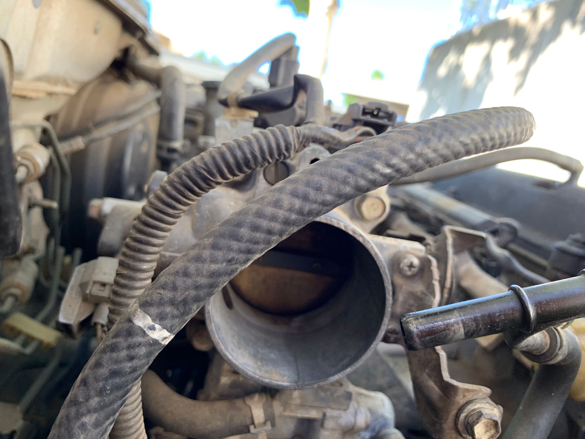

Is there a part missing something that goes over or connects to that circle part
This is a96 integra. It was stolen we got it back . Is there something? missing any parts missing. Thank you
And if so can I drive it like this or no better not

Idk if you figured it out yet, but you're missing your air filter there, the big black hose that leads to a big black box. And I accidentally inserted my 96 Integra key into my 99's ignition (and it f'ing started, easiest car to steal and probably how yours was stolen) and it wouldn't come back out. I tried twisting really hard but it didn't work, I tried putting the key forward (without starting) and cycling the gears (automatic) P through 1st then as soon as I put it back into park I twisted it back and it let it out. I also ended up being my 96 key, unsure if that helped release it, but it still starts my 96 as well
