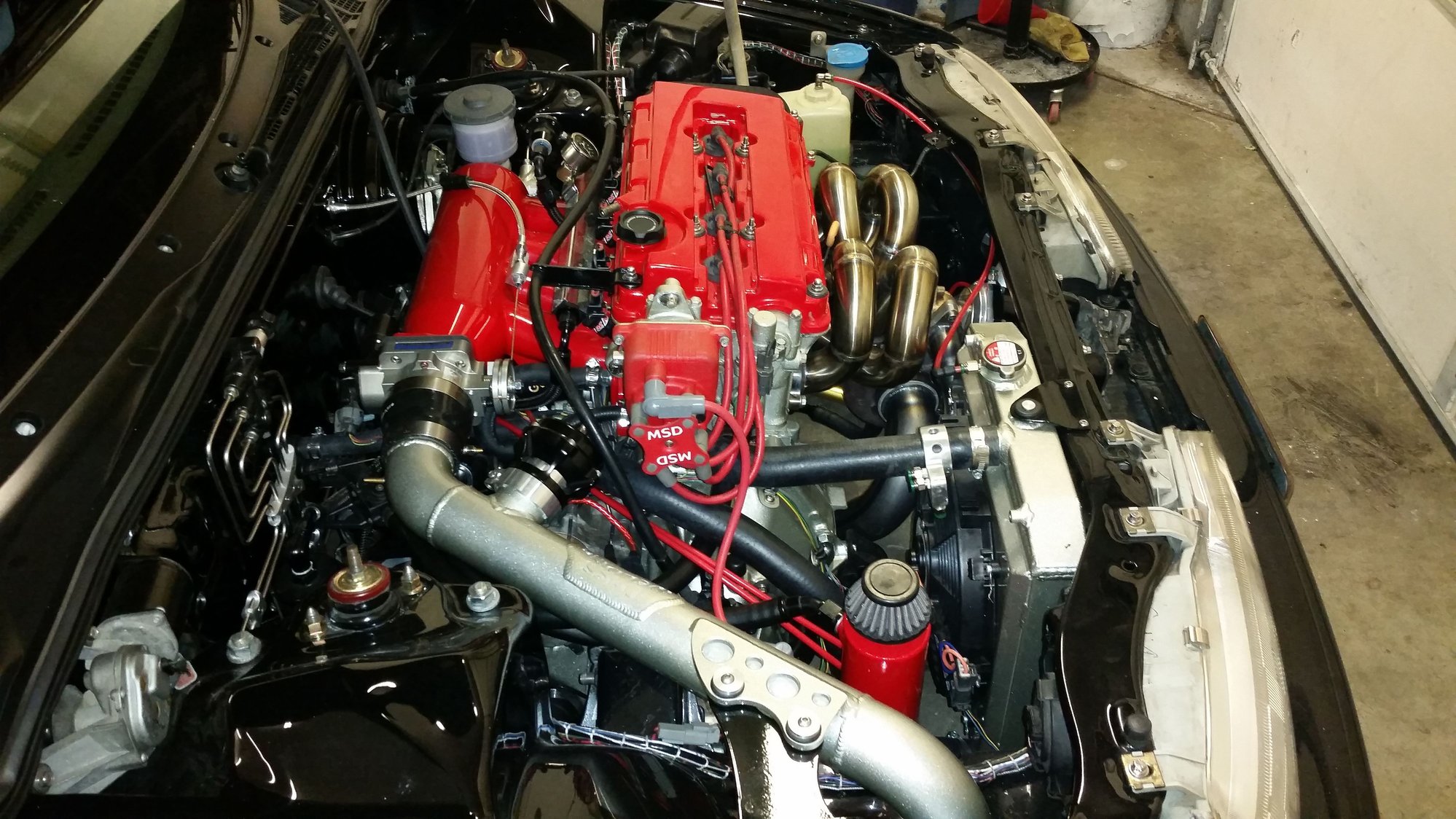

Here are some pics of how things are laid out in the bay.
Not the best pics, but all I have on my phone
250 is ridiculous and wayyyyy over heating. I have my protection enabled to throw a CEL when the temp hits 220.
Normal operating temp is around 190 degrees.
How are you measuring the temps?
What does the cluster temperature gauge read, maybe your aftermarket sensor or gauge you are using has an issue?
What engine management is the car running? 25 is conservative, maybe a bit high around idle though if you meant 25 through all ranges.
Setup looks great! May just want to wrap the DownPipe to help with heat.
