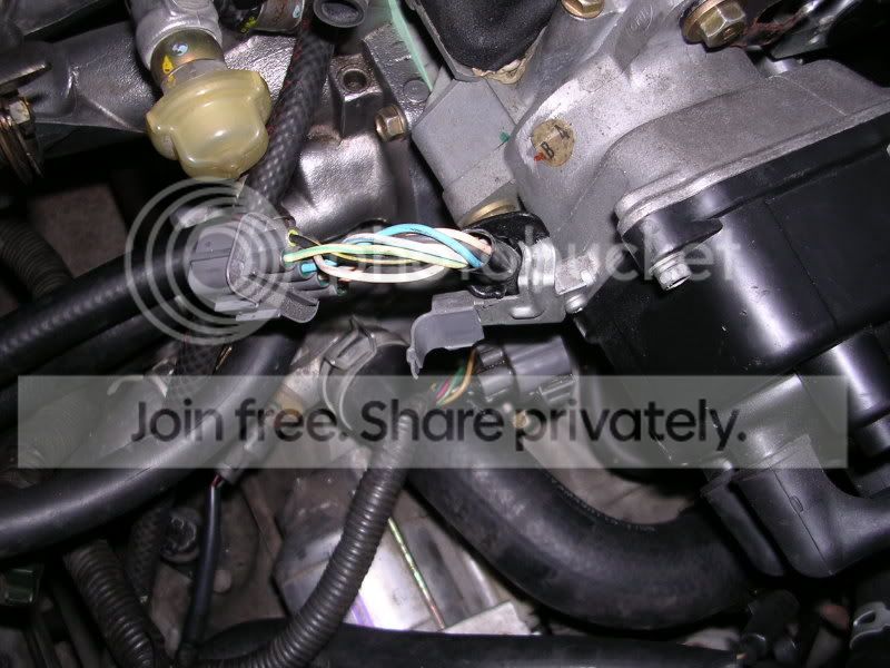

Here is my dizzy plug on the right, the left is from my harness...
What plug is this? It doesnt seem to go anywhere and what is covering it?

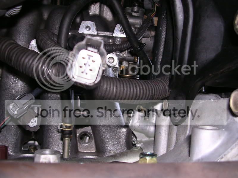

And this plug here... I dont see any other possble place for it to go. But i wont connect here...

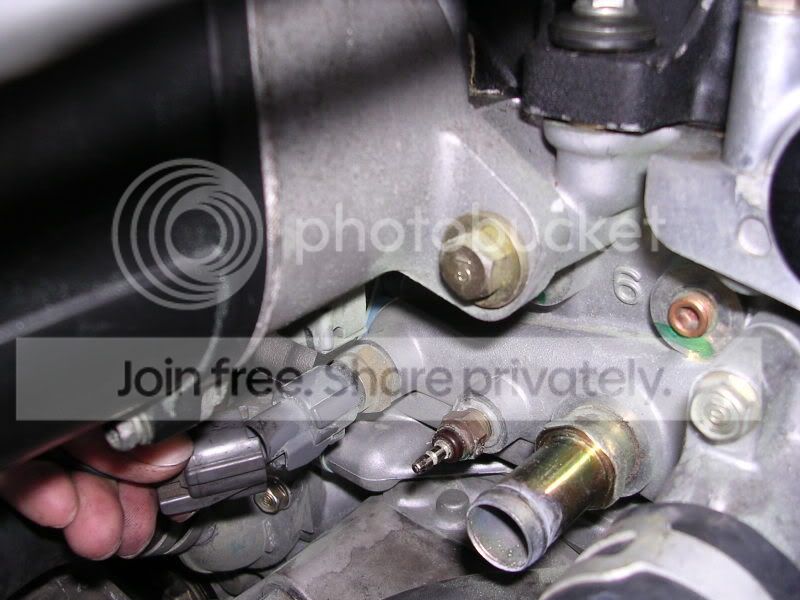

Ok, so here is the latest problem... these connectors dont seem to go anywhere... These are taken behind the intake manifold under the car..
I see a brown connector on the block but nothing seems to hook up there... The first plug is round but wont seem to fit... The one behind the first plug i just plain dont know where it goes...

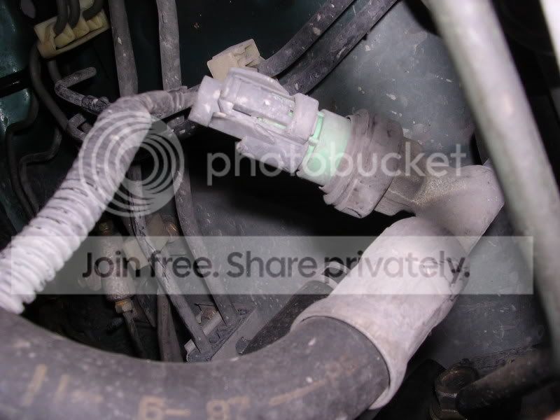

This plug just hangs near the firewall... what is it? Where does it go?

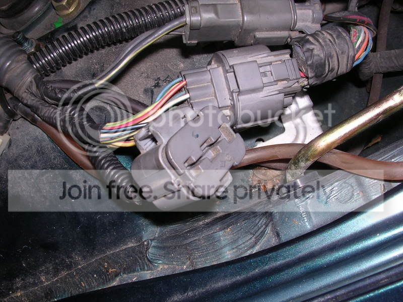

And this connector is connected here and routes through the firewall... its not part of the harness and DOES NOT touch the engine...

the plug in the second pic doens't connect to anything. i thing its for diagnostics at a stealership or something..... maybe i'm wrong, but i could be right....

<TABLE WIDTH="90%" CELLSPACING=0 CELLPADDING=0 ALIGN=CENTER><TR><TD>Quote, originally posted by pdotjones &raquo;</TD></TR><TR><TD CLASS="quote">the plug in the second pic doens't connect to anything. i thing its for diagnostics at a stealership or something..... maybe i'm wrong, but i could be right....</TD></TR></TABLE>
no, thats the grounding box for the injectors.
pics one the dizzy OBD2B and the car is OBD2A.
just change the plug out its all the same colors very easy to change.

if it is a 99 b20 that means it is obd2a NOT B. therefore the harness is compatible. I think you might have an obd 1 dizzy. does the dizzy have more than one plug on it? also the third picture looks like there is a clip on that sensor..take the clip off and put the clip from your harness on it.

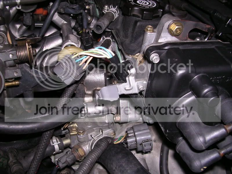

<TABLE WIDTH="90%" CELLSPACING=0 CELLPADDING=0 ALIGN=CENTER><TR><TD>Quote, originally posted by GsrIntegra789 &raquo;</TD></TR><TR><TD CLASS="quote">if it is a 99 b20 that means it is obd2a NOT B. therefore the harness is compatible. I think you might have an obd 1 dizzy. does the dizzy have more than one plug on it?</TD></TR></TABLE>Yeah, someone else told me that same thing... Im pretty sure it has only 1 plug... And i dont see how it could be OBD1 since B20s only come in OBD2... Maybe Hondamotorsonline slapped an OBD1 on there, sure is giving me headaches if they did.. Im gonna go check.

I just checked... there is only ONE plug there... Is there a way to determine if the harness is actually obd2 like the seller said it was...

do me a favor ..take pictures of your dizzy so i can see for myself cuz this is strange. and yes there are ways you can check. If it is an obd2 harness you will have an a plug that goes to the crank. (crank position sensor). I think thats the easyest way to check if it is a obd2 harness and also the plug for the dizzy will only have one plug not 2

Pics are uploading now... There seems to be a broken piece of plastic there. Possible connector? I dunno... pics are comin...

If you look there you can see a grey broken piece of something... I wonder if it was the other plug that identifies it as OBD1...

that is deff. an obd1 dizzy with the coil plug cut out or something. i have no idea why its missing

<TABLE WIDTH="90%" CELLSPACING=0 CELLPADDING=0 ALIGN=CENTER><TR><TD>Quote, originally posted by GsrIntegra789 &raquo;</TD></TR><TR><TD CLASS="quote">that is deff. an obd1 dizzy with the coil plug cut out or something. i have no idea why its missing</TD></TR></TABLE>Are you sure? I dont see why it would be OBD1... HMO owes me a new dizzy then, What about the other plugs not working... Like this one...

the other sensor i told u about. You need to take the clip off that is on there already. and just slide the plug from your harness on to it. and no u do have the right harness. are you located ne where near jersey?
