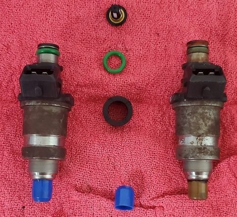

I used a kit from here on mine to rebuild them, basically new seals and rubber
https://theinjectorshop.com/products...98a6ce0d&_ss=r
I replacing the filters on mine seemed to really quiet down the injector noise and cars seems to run better up top, I think the 25+ year old filters get a little hard and possibly clogged
I have used 2 kits and been happy with both, one on a Jdm B16a with original injectors and one on LS\B20 with original 95 LS injectors

Old Oct 1, 2020 | 05:33 PM
egsleepercivic's Avatar
Posts: 3,421
Likes: 23
From: The South
Default Re: Injector leak
here is a pic of one "rebuilt" vs an original
