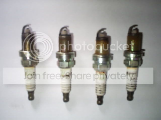

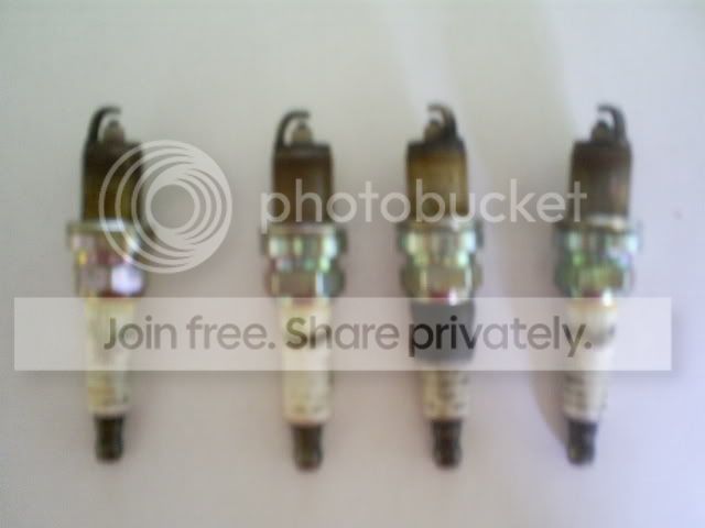

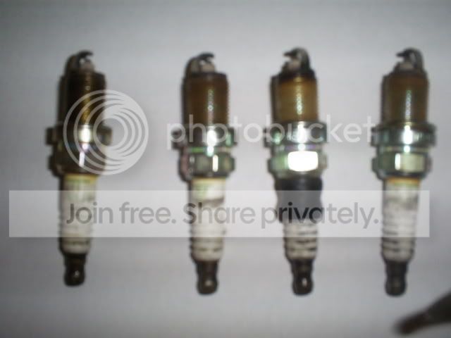

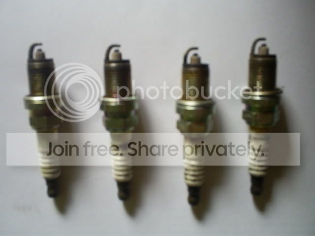

here are some pics of the plugs when i changed them. sorry for the shitty pics.
[IMG][/IMG]
[IMG][/IMG]
[IMG][/IMG]
[IMG][/IMG]
maybe this helps

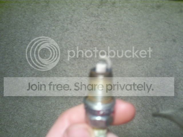

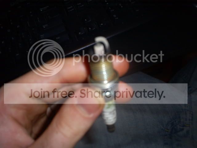

tell me wat u think of this. the white tip
[IMG][/IMG].
[IMG][/IMG]

The white tips on the spark plugs indicate you are running lean. Are you sure the spark plug wires were put on in the correct order?
Also since it seems you are getting less fuel than you should, check the injectors.
Check all your grounds. Even if they are tightened down they may not be getting good connection. Use steel whool and brush off the area where the grounds meet the frame to get good connection.
Last, check your battery and alternator. Make sure the wire under the little rubber cap on the alternator is getting good contact. You can also clean this area off with steel whool. I hope this helped. Good luck.
