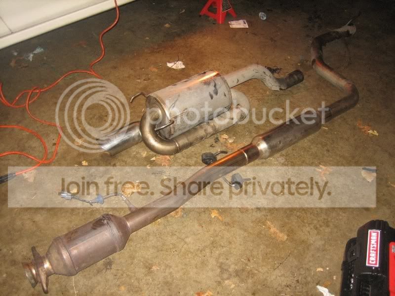

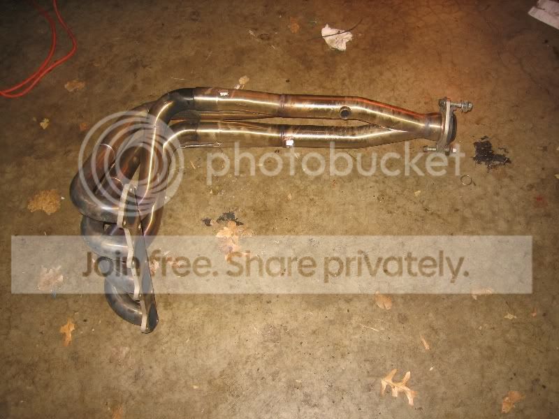

Old Oct 20, 2007 | 12:19 PM
pennies_hatchie's Avatar
Joined: Aug 2002
Posts: 8,117
From: Jordan Michael, Minnesotian
Default Re: (beastman@)

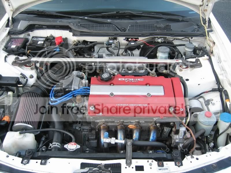

I couldnt find any from underneath but here's some pictures I have of my old setup
(Rage + Hytech + B18C5)
Notice the length of the header (longer) and catback (shorter)

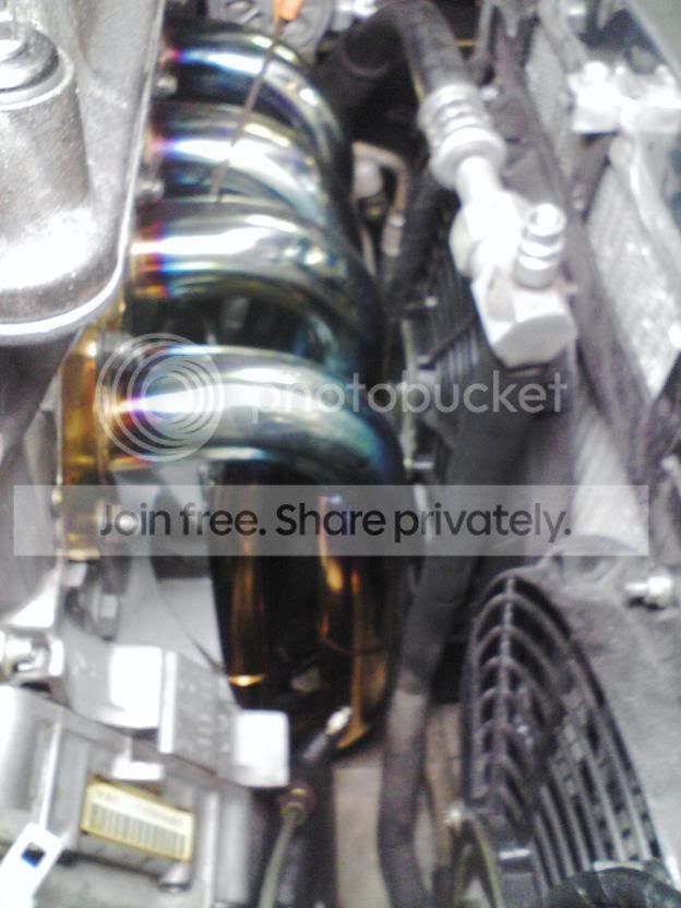

<TABLE WIDTH="90%" CELLSPACING=0 CELLPADDING=0 ALIGN=CENTER><TR><TD>Quote, originally posted by beastman@ &raquo;</TD></TR><TR><TD CLASS="quote">Anyone got pictures of this installed? gsrob hook it up with some under the car pics.</TD></TR></TABLE>
Hang tight, I will take a pic of my exhaust set up tomorrow so you can see how I am running mine. I also sent ya a pm back. Just so you know, the set up sounds killer that I am running, no over the top, loud or obnoxious sounds. The header has plenty of clearance as well even though my car sits pretty low on with my teins.

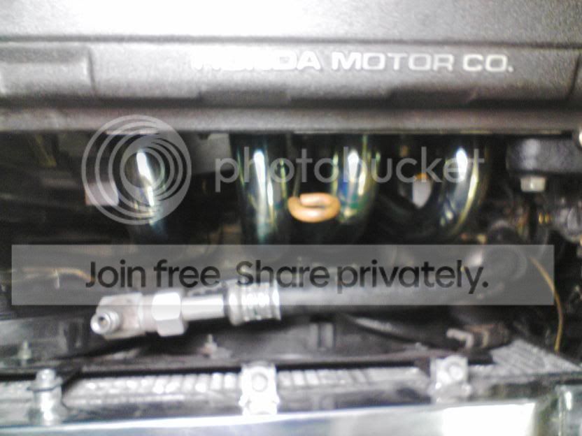

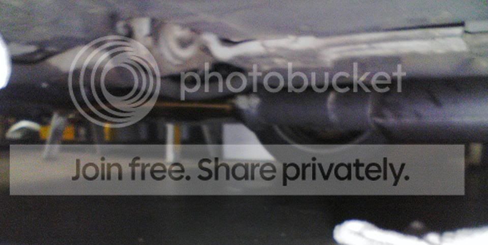

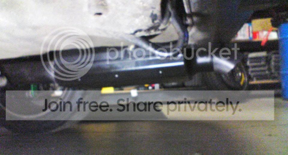

Old Oct 21, 2007 | 01:54 PM
gsrob's Avatar
Posts: 860
From: VA
Default Re: (gsrob)

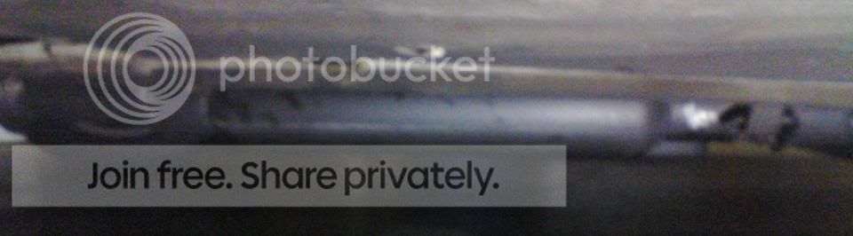

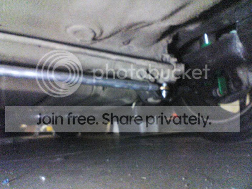

I got all the way down to the shop and forgot my camera. So here are some pretty bad quality pics with my camera phone. It's kinda hard to make out the exhaust since we sprayed it black.
Old Oct 21, 2007 | 02:37 PM
beastman@'s Avatar
Posts: 343
From: BOSSton, MA, usa
Default Re: (gsrob)
Is your radiator stock? Looks like the hytech rep is coming pretty close if not rubbing. ps your tranny is so clean it looks brand new
Old Oct 22, 2007 | 07:55 AM
gsrob's Avatar
Posts: 860
From: VA
No, I have a Godspeed Aluminum radiator with slim fans. There is nothing rubbing. Actually nothing is really very close to rubbing either...The picture is kind of deceiving. I just had my motor and tranny rebuilt and I brake cleaned all of the build up off it before the reinstall. It's a good thing you didn't see it before.
