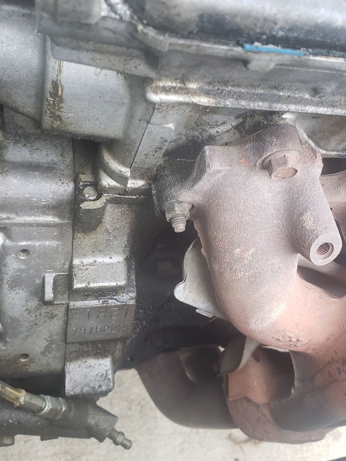

i really appreciate the responses, and I already replaced my rad yesterday...but where the hell is the drain bolt??? Am i retarted? Sorry for the large pic, but I need to show the detail. The bolt on top of the bleeder bolt leaks oil, so that can't be it...
hmmm...the red plug seems to be connected to my block heater, so I guess that it? Oh well, I guess I'll drain it next year...

it's right below between the cylinder 4 and cylinder 3 exhaust primaries roughly 8-12 inches below it.

its the only 19mm bolt on the front of the block.

where the block heater is... that is where the drain would normally be... i have never seen one of those in person yet but i figure u can take it out... just unplug it first... afterall that is the standard drain bolt

DETAIL your motor man... if it was clean you might be able to find something big like a 19mm bolt..
Modified by whiteGSR at 2:28 PM 6/22/2003
that one bolt hidden in the dark
