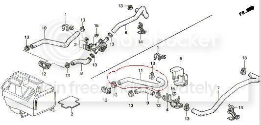

Ok so one the hose in my car has a hole in it and it is spewing out coolant. I looked on here: http://www.sonsacuraparts.com/...ch=no to find the name and/or part number for it but it doesnt list it. Does anyone know exactly what the part number for this hose is and if i can get it at a local auto store?
The hose i am talking about is circled in red. Thanks in advance!

If i'm looking at it right, it's the heater core hose.
Just buy any heater hose from any parts store, and splice it in. No need to buy a special part from honda.

looks like theres a 90 degree bend....not sure can u just use regular hose to make it fit like that...but it might be possible...try it out.

using a non-molded hose will cause kinking and obstruct coolant flow
