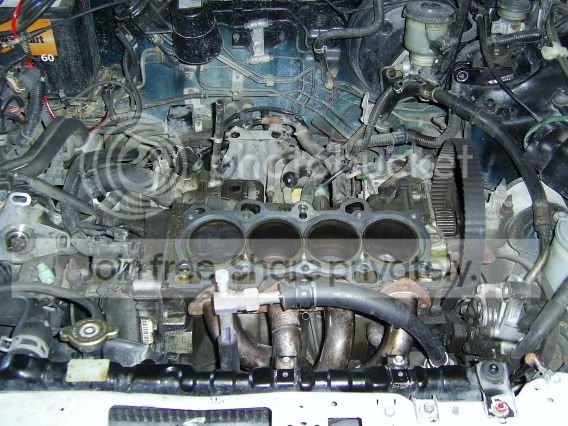

Found the hole, right behide the A/C compressor. So the LS/Vtec will begin. Also one of the valves will not seat/seal, I'll take it to a machine shop and have them take it out etc.
Heres a pic:

<TABLE WIDTH="90%" CELLSPACING=0 CELLPADDING=0 ALIGN=CENTER><TR><TD>Quote, originally posted by chu77 &raquo;</TD></TR><TR><TD CLASS="quote">Heres a pic: </TD></TR></TABLE>
Where's piston #1?

Piston #1 moved freely up and down, its down in that picture. I'm guessing the rod snapped.
