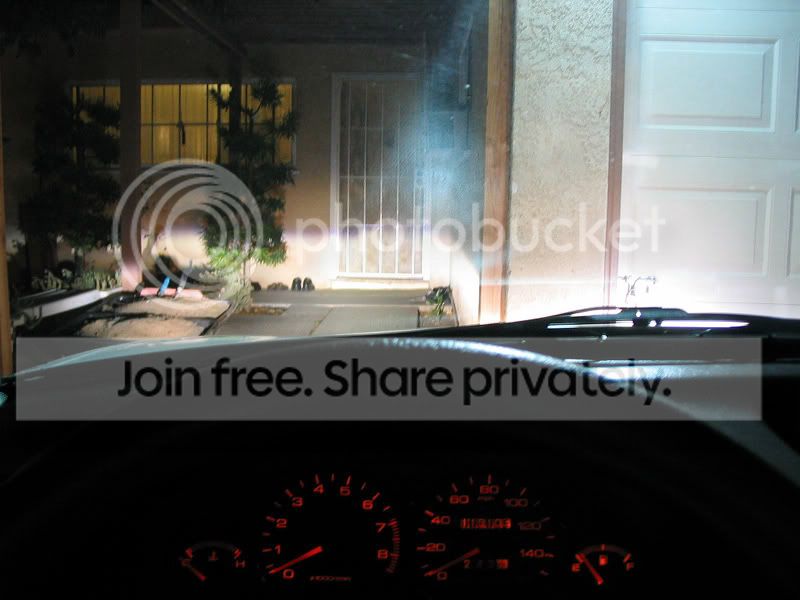

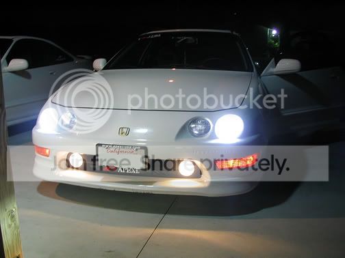

it's almost unanimous....get yourself something 4300K. Since that's what OEM uses, and why does OEM companies such as Acura/Honda, BMW, Lexus, Audi, Mercedes, Infinity, and Nissan use 4300K? CUz it's cooollll??!! Nah man 4300K gives you the MOST LUMENS. K is the measurement of color temperature, while lumens is the measurement of brightness. 4300K gives you about 3500 lumens while ur 8K-10K gives you approximately less then 2000 lumens. Which is a bit more then your halogens. Hey it's still more then stock but it sucks *** compared to real HIDS.
Retro or HID KIT???
Sure with a HID kit you might need that 6000K+ kit to get yourself a bluish color. But remember the rule of thumb here...higher K, lower Lumens. But why does oem give you that nice blue at only 4300K, especially when 4300K is closest to daylight = white light. OEM gives you that blue color not because of the bulbs, but because of the projectors. The way the projectors are designed gives the colorful characteristics of the light and the colorband in the cutoff.
Beggers can't be choosers, if you go HID Kit you're stuck at a choice of usuable light or "pretty" light. Get yourself a retro and you can have the best of both worlds.
a 4700K hid kit
a 8000K hid kit
both made my McCulloch.....you be the judge.
Do it right the first time around, go retro...or if that's not your thing, go 4300-5000K
