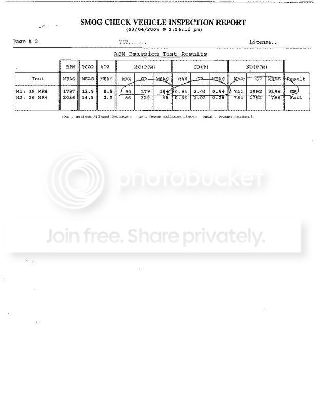

well what can it be?
i have no mods, its bone stock 94 acura integra RS 210,xxx miles
uhm i don't know much about cars or how to work on cars ..
any advice is greatly appreciated

Change your oil. Post your levels and limits.
Old Mar 5, 2008 | 09:48 AM
ThaLost0ne's Avatar
Posts: 1,583
From: Tree hugging state :(
Default Re: Help, failed smog test only (Dogginator)
thanks for the replies
<TABLE WIDTH="90%" CELLSPACING=0 CELLPADDING=0 ALIGN=CENTER><TR><TD>Quote, originally posted by Dogginator &raquo;</TD></TR><TR><TD CLASS="quote">Change your oil. Post your levels and limits.</TD></TR></TABLE>
post what?

<TABLE WIDTH="90%" CELLSPACING=0 CELLPADDING=0 ALIGN=CENTER><TR><TD>Quote, originally posted by ThaLost0ne &raquo;</TD></TR><TR><TD CLASS="quote">thanks for the replies
post what? </TD></TR></TABLE>
Nevermind, the pictures are blocked where I currently am.

Seriously. Used it in an 88 Civic that was failing worse than you. Passed with a safe margin after using it.
ISO Heet also works, if you can find it. It doesn't exactly freeze here in SoCal, so stores don't normally carry it.
<TABLE WIDTH="90%" CELLSPACING=0 CELLPADDING=0 ALIGN=CENTER><TR><TD>Quote, originally posted by Dogginator &raquo;</TD></TR><TR><TD CLASS="quote">Change your oil.</TD></TR></TABLE>
Changing the oil in my 00 GSR dropped my measured HC from 65 PPM to 49 PPM, which just passed the 50 PPM limit for my year.
Also, you can ask for a "pre-test" which is a full test without submitting the results to the DMV. That way, if you fail it isn't recorded, and if you pass have them do the official test immediately afterwards.
