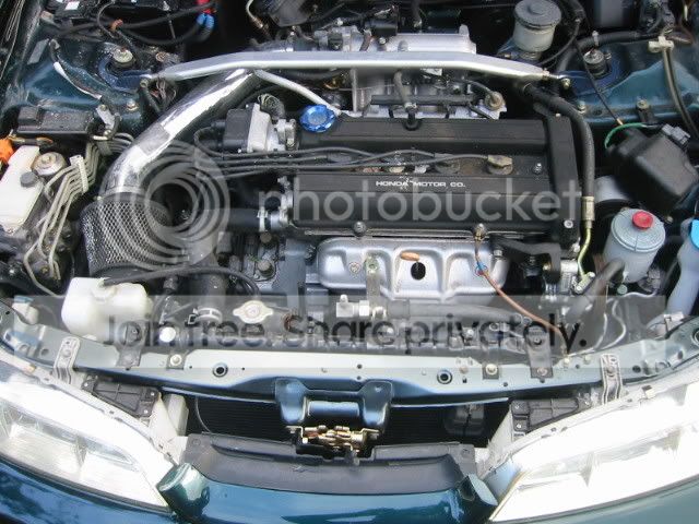

Old Jan 20, 2008 | 10:48 PM
Greasemonkey75's Avatar
Posts: 159
From: 425, Wa., USA
Default Re: (tunerplayground_dc2)
If you look right next to the airfilter, thats the Modulator. The gold cyl. is the accumulator. Look and see if that sticker is "leaking"
