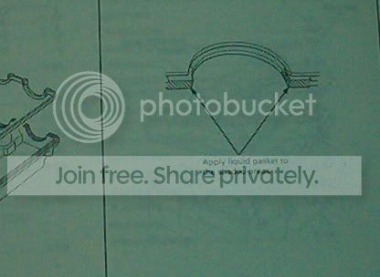

does that manual you got also show a poc of where to put the hondabond? just trying to get a visual of it.

<TABLE WIDTH="90%" CELLSPACING=0 CELLPADDING=0 ALIGN=CENTER><TR><TD>Quote, originally posted by mrrugsr &raquo;</TD></TR><TR><TD CLASS="quote">does that manual you got also show a poc of where to put the hondabond? just trying to get a visual of it.</TD></TR></TABLE>
here ya go, lol i took all these pics when i needed help with my oil pan

THANKS FOR THE PIC MAN
The tranny is on the left in the pic correct?

^^ what is the red arrow for? It shows the sequence as middle two going across the pan, then right two going across, then left two going across, for the initial 6 bolts.

<TABLE WIDTH="90%" CELLSPACING=0 CELLPADDING=0 ALIGN=CENTER><TR><TD>Quote, originally posted by PatrickGSR94 &raquo;</TD></TR><TR><TD CLASS="quote">^^ what is the red arrow for? It shows the sequence as middle two going across the pan, then right two going across, then left two going across, for the initial 6 bolts.</TD></TR></TABLE>
yea if you notice it says to tighten those 6 bolts first finger tight, then to torque the rest clockwise in 3 steps

<TABLE WIDTH="90%" CELLSPACING=0 CELLPADDING=0 ALIGN=CENTER><TR><TD>Quote, originally posted by mrrugsr &raquo;</TD></TR><TR><TD CLASS="quote">THANKS FOR THE PIC MAN
Yea i should get the helms huh</TD></TR></TABLE>
yes tranny is on the left
