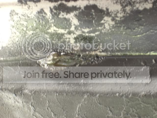

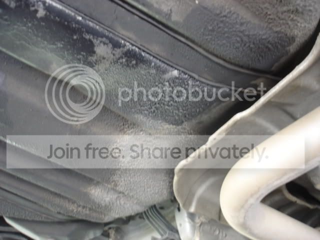

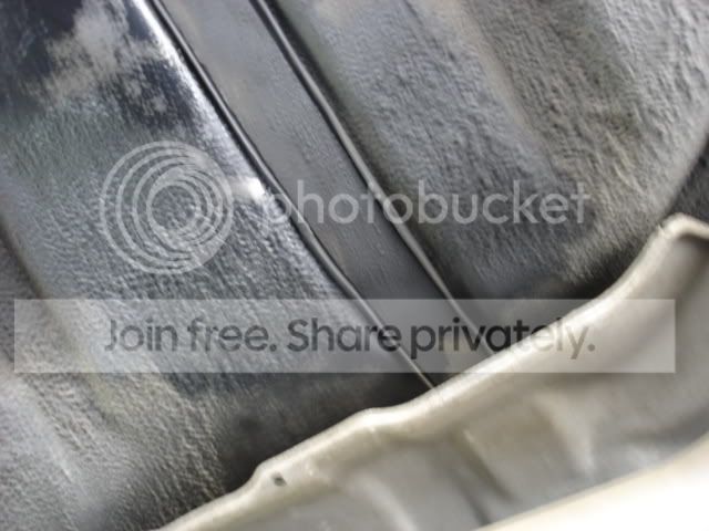

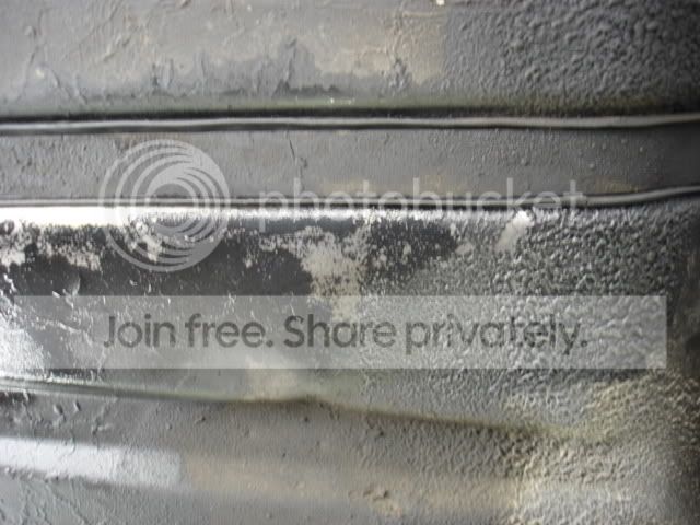

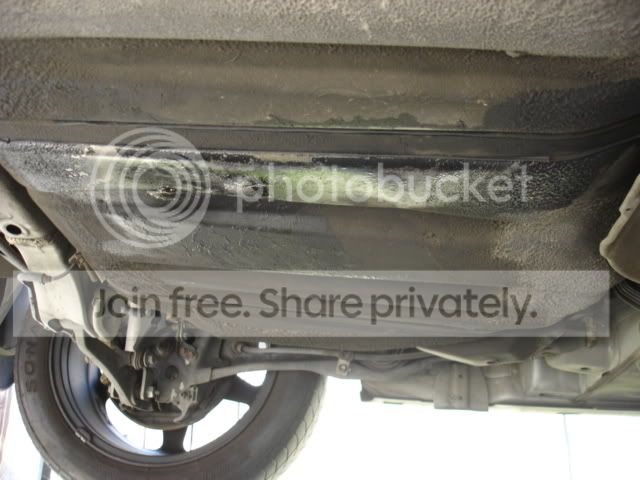

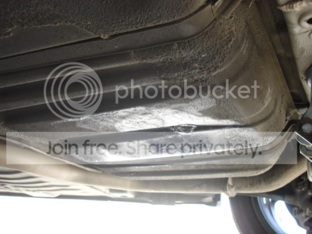

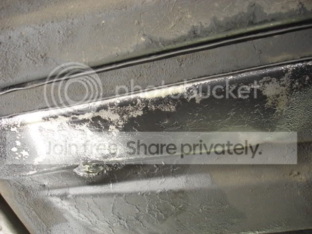

well i started to smell some gas in my garage so i jacked up the hoopty and this is what i saw....its drippin like a drop every 10secs......help please....thanx in advance

they do make a gas tank patch..my friend had to use it on his EK..it holds up just fine..no leaks at all. you can get it at autozone.

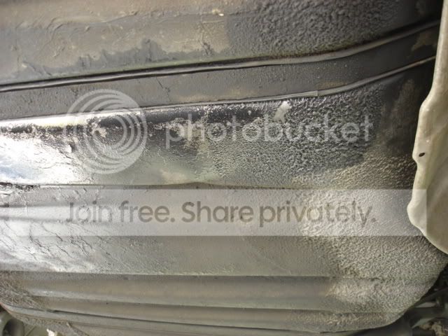

through further inspection it looks like it has been patched before by pevious owner... ....i've had the car for almost 4 years...well the dripping has stopped and i took the other patch off....so i went to Autozone picked up another patch....sanded down the hole rubbed with an alcohol swab provided and put the thing on... ....i'll see tomorrow if it holds up and maybe hold up for another 4yrs??????...or should i just go and get a new one??????

awesome no more gas leak!!!!

Nice job fixing it. It was that other patch job huh?
