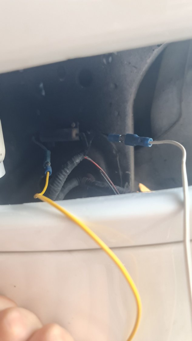

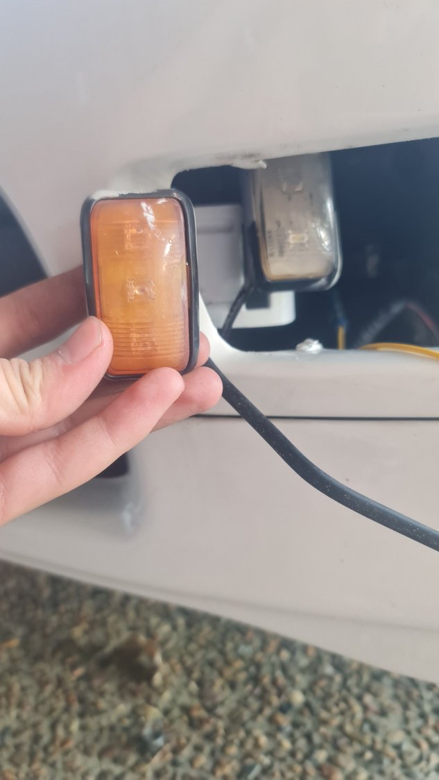

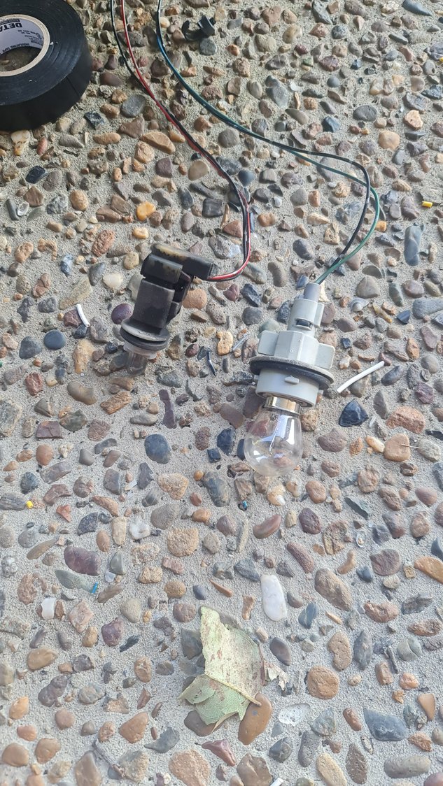

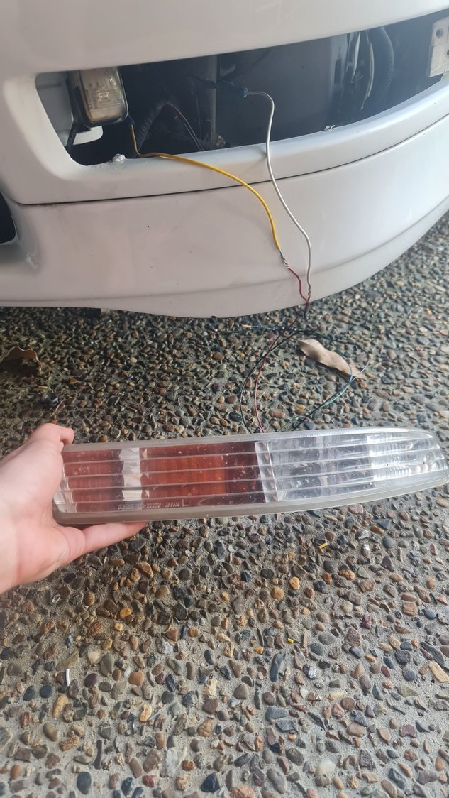

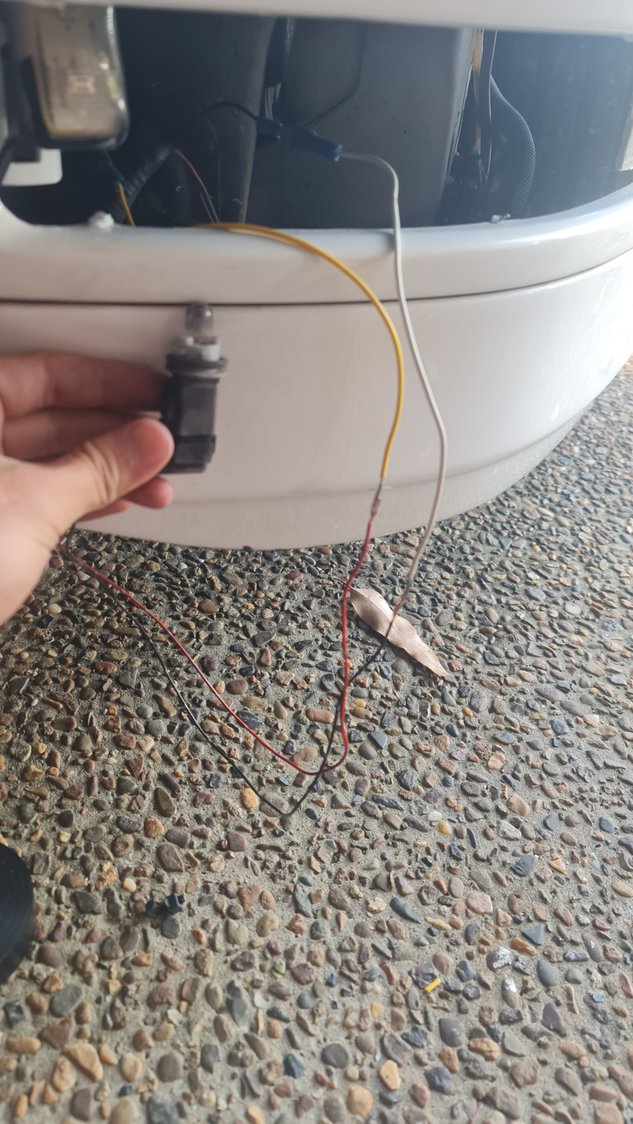

So I bought this 94 integra with both the front indicator housing missing from the previous owner, it looks like the tried to use some little lamps as indicators and high beams for the front indicators and lights on both sides and they wired it in with some weird connectors. I bought used indicator housings off a junkyard integra and I've tried wiring the bulbs to the corresponding wires, but I haven't been able to get the indicator bulbs to work. The ones I'm assuming that are for the high beams work as indicators but the large bulbs that go into the orange part of the indicator housing don't work when I use the turn signals. I don't know why they aren't working, is the little bulb the indicator or Is the big one supposed to be the indicator?

Orange lights (turn signals) — 3 wires
clear lights (parking lights). — 2 wires
Each light unit should have (2) different plugs
