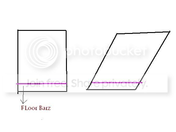

WEll, thats not EXACTLy it...
Bracing the floor area is a method of keeping the floor from bowing in like this ( ^ )....or seperating out or twisting diaganally, if you see what I mean...Same thing goes for the trunk well/spare tire well...Rear strut braces are less effective then bracing the trunk well...
Ideally, you'd want to tie all the floor points together, that you could, to make the floor as rigid as possible.
Old Mar 22, 2006 | 05:16 AM

Bowing? at what point in time does your chassis want to bow?
specially in the back? that's what the strong pillars in front of the rear shock towers are for.
Not that bowing is common unless in a T bone accident..anyways.
even then a little bar with TWO contact points is going to do anything....that back bone of teh car is pretty strong/er
for diagonal twisting, im sorry but picture it in your head and that bar does not help.
what i have been trying to get at is that you want to form triangles; triangles are your friend.
a straight bar connected with only 2 points its only going to provide stiffness in as you say when bending and when forces are applied horizontally to each end.

Ok dude, obviously you seem to think that im talking out of my ***, im just going to give up into explaining something you dont seem to understand or maybe want to understand.
You keep bringing up minor and very basic explanations to the matter..
of freaking course the floor wants to flex... but that bar will do nothing for the kind of flexing the floor wants to do....SPECIALLY where the bar bolts on to..
have you looked at the layout of an integra chassis lately?
Its just your opinion against mine
