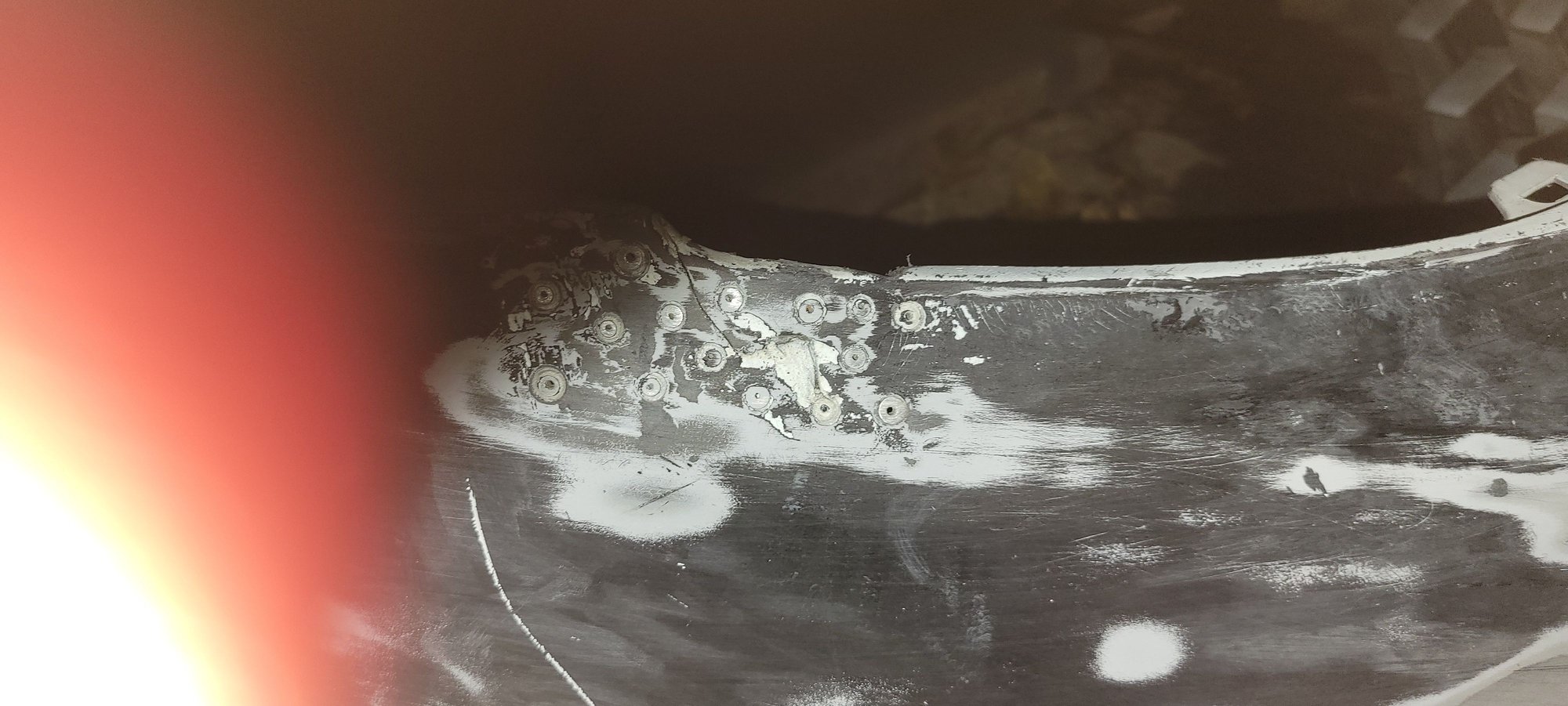

Best way to fix this last guy got started on it and its stable but looks like crap thanks

i assume the bumper was cracked bad and previous owner riveted a metal plate on the back side?
just get another bumper. if you are unable to afford to get another bumper or have it repaired by a professional, then just leave it as is.
if you want to learn, then get yourself a nitrogen plastic weld machine and youtube.
if you want to half *** it, then drill hole at the end of crack, use a solder iron and weld it yourself.
you will need to use plastic filler on the panel. sand, prime, paint
from your previous response to MotorMouth93, im guessing you dont plan to invest much into a repair

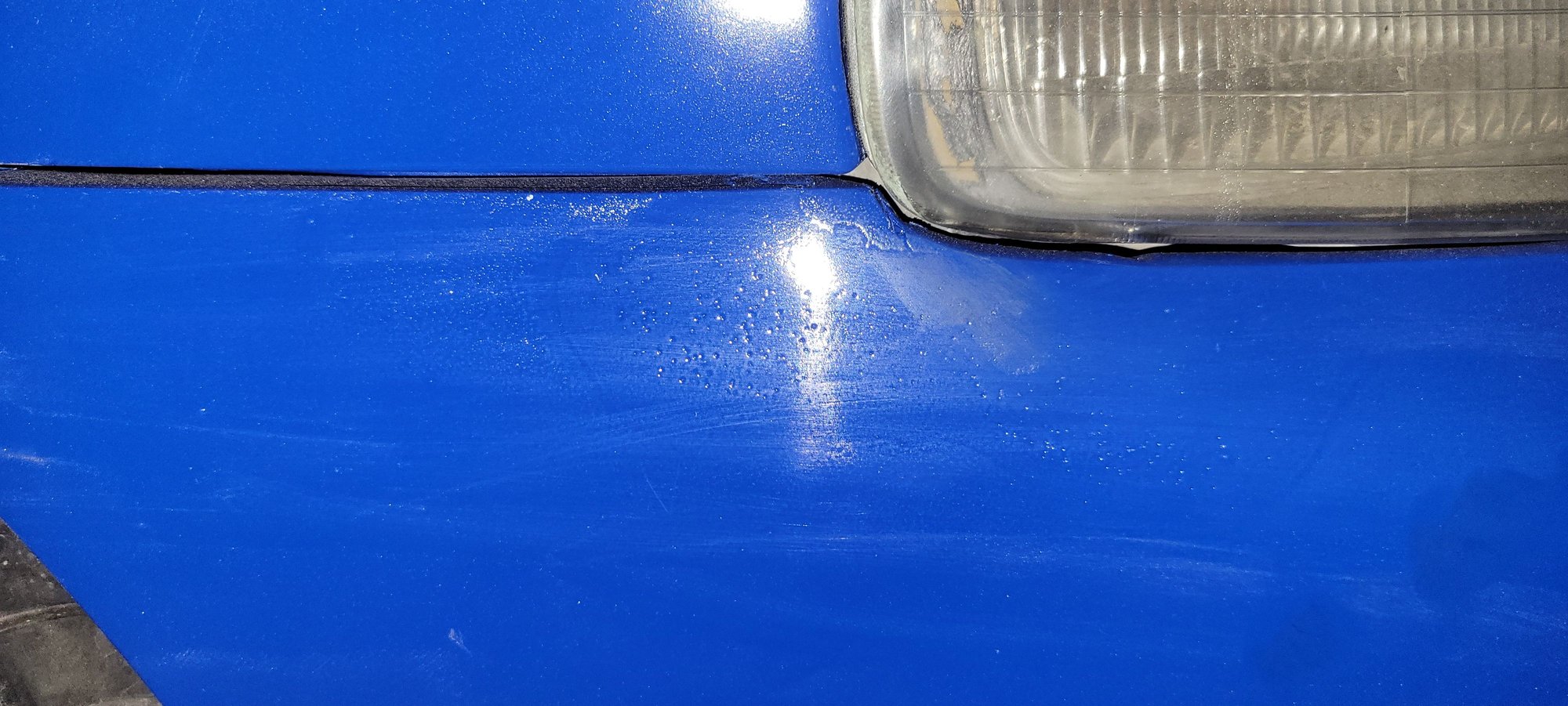

Jb weld

hmm yep, still looks like ***.

But who is going to look that close lol

then why post a pic of it that close up that shows it looking like that? If you post a pic from farther back where most people will see it, it might look amazing.
