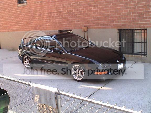

dude that car is ******* sick as hell man!!!! ill give you that dude im in love with that... you see i love my baby too 97 Ls with the dark blue paint, no spoiler...... but im going to be switching my auto out for a stick shift..... so in about a year ill be on here asking these questions haha
how much did you buy that spoiler for? and where from?? and also what about that intena? that ******* stock intena is ******* ugly it rises so high so i wanna get a new one

i got the same spoiler, its a type-R spoiler. you can get it from partstrain.com for around 100 bucks unpainted.
also, what kind of rims are those? they look really clean.
well it is the stock antenna but it doesnt rise anymore.. it just sits there like that. I disconnected the motor so it doesnt go up or down. I get good reception too.. its weird lol. the rims are 5zigen fn01r-c's.
I did alot of research before i bought them so thanks for noticing.

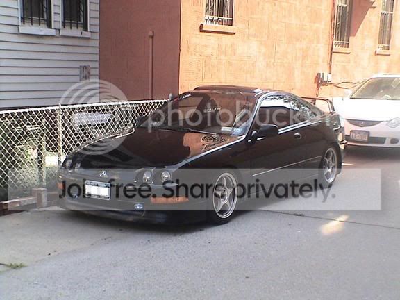

heres a few new picz. thanks for the comments
