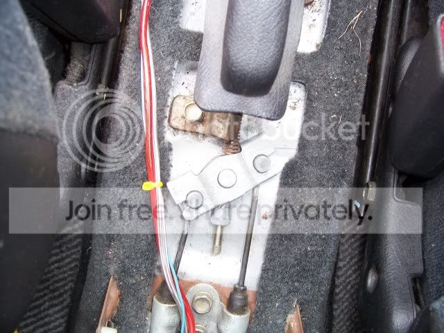

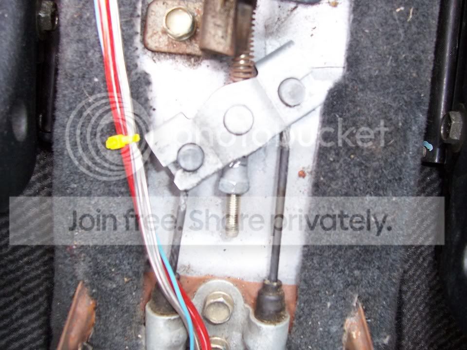

I bought my dc bout 3 months ago ... The ebrake has always been very very loose to the point that it hits the top of my console. I would always leave my car in gear when parked cause the ebrake wouldnt hold up. So i figured its bout time i fix this lil problem. so i went ahead and took a look at my e brake ... i noticed that the drivers side brake line is shorter then the other ... i found that weird. So ne way i tighten it up so that at about 6-10 clicks its pretty firm.
Problem is when i slam on the ebrake my tires wont lock up .... and my driver side seems to have more stoping power then the passenger side.
could this be because my brake line? I got some pics and you can see what im talking about, you can also see how much i had to tighten it to from where it was originally at.

If you have it adjusted correctly, offset or not, you should be able to lock up both back wheels by pulling hard enough.
Jack up car, have 2 buddies spin back wheels by hand, SLOWLY pull up cable and await feedback from the first one of your clown friends that says "I can turn it", then you know which should be adjusted or is outta whack.

Ok once i know which side needs adjusment, how do i adjust it? The e brake only has one nut thas connected to both lines ... so how would i adjust one line?
I was also told that maybe my lines have streched out and that once that happens it'll just keep happening but i dont know.

there might be more than one place to adjust the e brake lines as well. check the end of the lines close to the brakes and look for adjusters.

so i should follow the brake line all the way up to my e brake right? but isnt there two different lines? one pair are for my reg. brakes n a whole seperate pair for the e brake right?
Old Aug 9, 2005 | 09:03 AM
mrdeadman's Avatar
They let me pick
Posts: 3,690
Default Re: E-Brake HELP! (LSDC-4)
yes there are 2 separate lines. one set is hydralic, they are the ones pumping your calipers. the other is a cable, at least it should be. just have one of your friends fool with the e brake lever while your looking and you should see the cable twitch. the wheels will have to be of in order to see this close.
