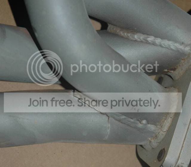

the crack on my DC header is similar to the crack in the picture shown. Would i be able to weld this? I'm not really looking to buy a new a header, just tryin to fix mines (for now).
Old Nov 8, 2007 | 04:21 AM
SoTexDC2's Avatar
Posts: 2,912
From: South Texas
You could probably weld it but depending on the exact location, the crack is likely to spread.
Old Nov 8, 2007 | 07:01 AM
jomama's Avatar
Posts: 3,979
From: Kansas City, MO, US
if your's is like that above, it's gone to hell and it's going to cost a lot to "redeem" it... lol. seriously though, you can fix it but unless you know how to weld yourself (and you wouldn't be asking this question to begin with, probably) or have a hookup to a welder, it's probably going to cost you a pretty penny to fix it. and considering it's a dc sports header which you can find at a reasonable price used nowadays, why go the route of fixing what you have when you can just find another that'll probably be the same price?

jb weld is ****. its just an epoxy. ill be surprised if that **** doesnt melt or peel from the extreme heat. it can be easily welded and as stated above it will spread so hit that **** ASAP

yea i can get it welded for cheap. I'm just looking for a quick fix lol. I'll probably just start looking for a new one. Thanks for the input everyone

yeah you can weld it, while your at it i'd weld over the others too just so it's a little stronger.

...Had an old DC 4-2-1 welded at least 10 times over 5 years before I finally threw it away, but I was driving almost 50Kmiles/year so that's not really too bad. It's any easy weld for most shops, should cost no more than 10 bucks.

Since it is a thermoset, it should burn not melt. Perhaps it wasn't fully cured before starting. Regardless, JB Weld is a poor option for an exhaust manifold.
I can't see the picture right now. Is the manifold SS or ceramic coated? I would drill the ends of the crack before welding to stop the propagation. If it is ceramic coated, you will need to remove the coating from the affected area.
