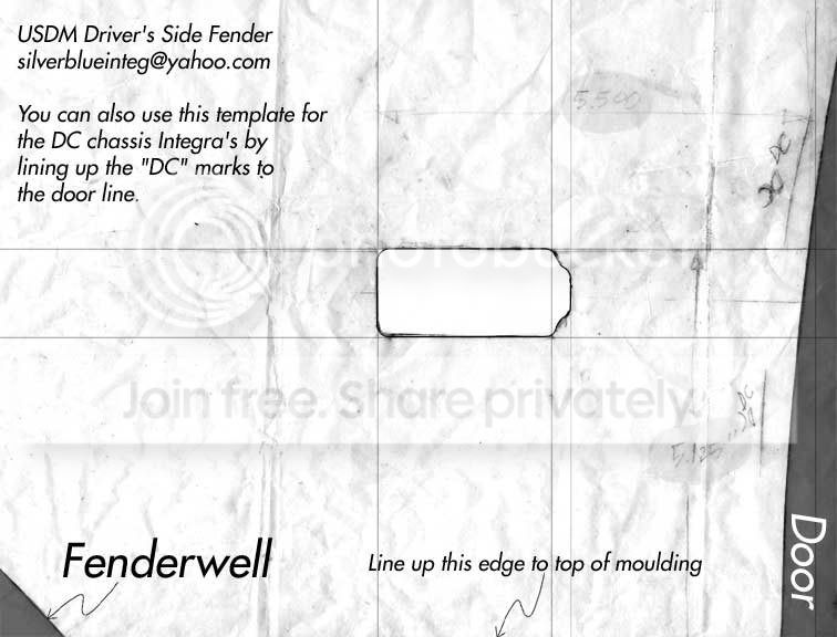

I have a Da side marker and not sure how I would cut the fender. What is the best way to cut the fender with out messing up the paint job? Is there a measurement for the side marker, like how high it should be from the fender molding? Thanks

Here you go:
Save that and print it out and line it up to your fender and molding

just make sure when you wire them up, they ONLY turn on with the signals, regardless of parking lights being on or not.

which is better? light on and blink or light off and blink?

light off and blink by far. green and black wires.

by any chance, anyone have one of those templates for a ek?
