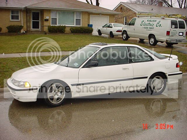

so i went to ntb to get an alignment (my camber is really off on the left front tire and i just replaced the ball joints) and they said it would take about 2 hrs. so i came back 2 hrs later, they havent even started it, and im like have u done it yet? then they pull it in and it doesnt fit on the dam rack! said it was to low.... i just bought the car so i have no idea what is on the suspension yet (too cold to check!) but i know it is slammed. rides pretty rough sometimes and the wheel shakes. i also get a squeeking on the front left sometimes it does sometimes it doesnt. (i think its because of the camber being so off) it also sucks on bumps....hits hard even the littlest bumps makes my cd skip..(its not the greatest player either) anyways my question is do i have to put some stock springs on to get an alignment and then switch it back? or does anyone know of a performance shop that may be able to do an alignment with it lowered? i live near chicago,il (bout 20 min away) any help or comments would be awesome

it looks a little too slammed.. check to see if there are camber kits. no camber kits = worn out tires fast.. and i dont care what anyone says about "oh just set toe to zero." that is complete bull****. Maybe on cars lowered an 1 inch. But even then. Over time, they will wear faster.
Do not get an alignment until you are done with the suspension and fixing any problems. Fix all problems (tie rod ends, upper and lower ball joints, axles). I would suggest raising it up a little with some H&R Race springs and some Ingalls 3degree camber kits in the front and some adjustable camber arms in the rear. Then take the car for an alignment. Most shops wont/cant do an alignment on a car that slammed low.. The ones that will do not promise a perfect alignment.

Well my car is a little lower than that and I was able to get an alignment no problem. Granted I live 500 miles away to it doesn't help you much. As far as raising it up getting it aligned then lowering it again will be pointless and defeat getting the alignment in the first place. Personally I would suggest (if you have to replace) the Omni power full set-up: http://robearracing.com/pd_omn...r.cfm.
All you will need for this is the upper control arms and camber kits.
As far as the jack goes, go to lowes, home depot or whatever and buy a 1''x6'' board. Have them cut it into different length pieces and make like 2steps on each one and screw them down so you can get your car high enough off the ground to get a jack under it. Good luck
