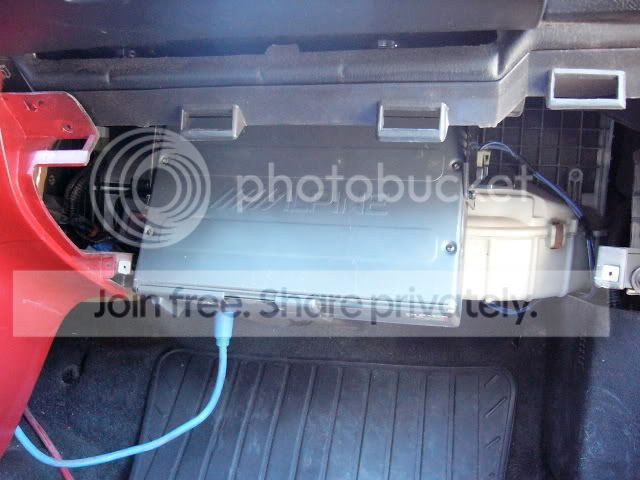

So i figured out the best way to hide a CD shuttle in a Gen2 teg.
Up under the dash under the glove box.
its easy to install and easy to access.
Remove the glove box and lower cover.
Pre mount the shuttle to the bottom of the glove box.
i used nuts and bolts to attach the bracket to the box.
Re-install the glove box, attach the CD shuttle brackets to the bottom of the box, install the shuttle to the brackets.

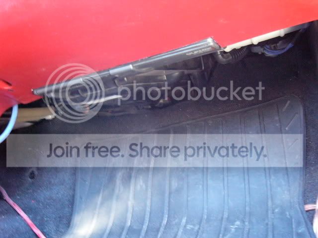

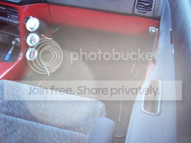

Now you trim the lower cover to fit the shuttle (see pic's)
Push play

Other than the blue wire, clean install.
