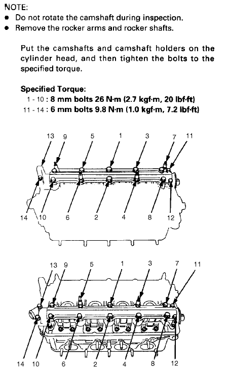

anyone know the cam guide torque spes for a 95 GSR
thanks

Default Re: cam guide torque specs? (cam003)

thank you

where do you get charts like that??

I'm pretty sure you can get it in the Haynes Manual.

i have 2 All-Data Accounts, one from my tech college and one from work. Those diagrams come straight from honda. Pay upwards of 2k and you can get them too!
