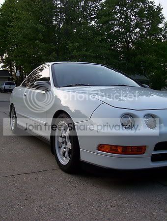

Previous Owners' Pics;

clean

Car looks clean!
