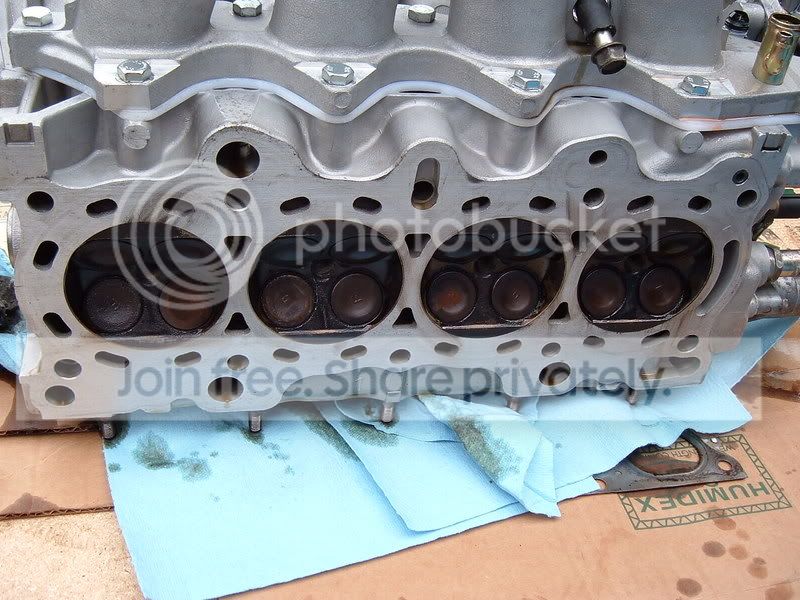

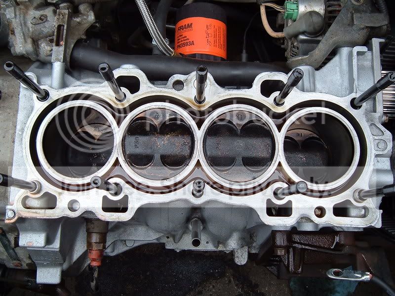

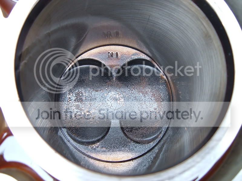

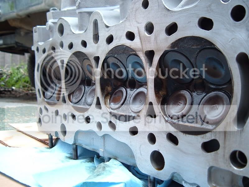

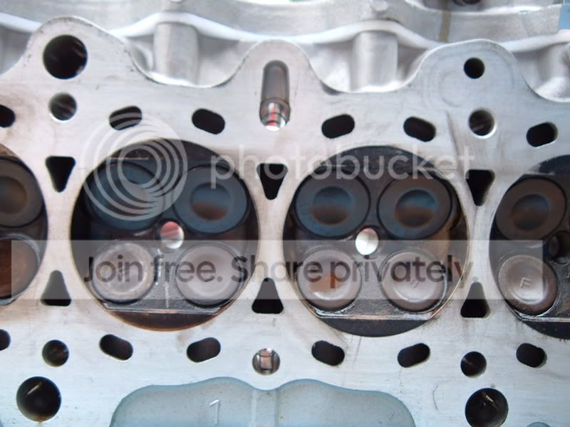

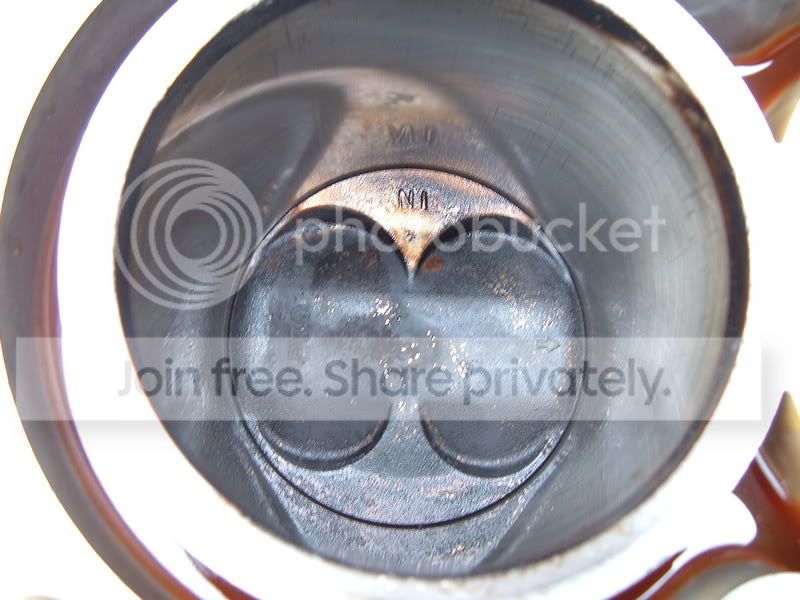

the valves arent bent that i can see. i have oil coming from the intake runners though. so maybe ive had bad intake valve seals? why would that make my leak down test be 100% leak down on cylinder 2 and 4, and 21%, 12% in cylinders 1 and 3? the exhaust valves are open at tdc for each cylinder, right? yet im hearing air bleeding out of the intake on every cylinder. timing is right, no coolant bubbles. im completely confused. here are a couple pictures of what the valves look like with 600 miles on them. cars ran rich for the first couple hundred miles. cylinder 1 and 2 ran better than 3 and 4 from what i can see. what should i do?

Default Re: Bent valves? (1badteg)
Have you adjusted the valves? They could have been too tight, which would hold them open and produce your symptoms.

<TABLE WIDTH="90%" CELLSPACING=0 CELLPADDING=0 ALIGN=CENTER><TR><TD>Quote, originally posted by 1badteg &raquo;</TD></TR><TR><TD CLASS="quote">only adjusted two that were too loose. they all were gauged and had enough clearance. what would explain air getting into cylinder 3 from 4? i will check the clearance again. thanks tons.</TD></TR></TABLE>
A bad head gasket could explain the linkage between cylinders. Check the head for warpage.
Inspect the head gasket closely. It could have been defective as well.

Default Re: Bent valves? (Dogginator)
also is scoring in the cylinder ok as long as your nail doesnt catch? in the second picture there is a couple scratches.
wasnt bent valves. i found that all my exhaust valve guides were drenched in oil and a couple intake valve seals and all exhaust valve seals were torn. i also found dual valves on the exhaust side instead of the intake side. when the head was reassembled by a local machine shop they really messed up. thanks for all the help.
