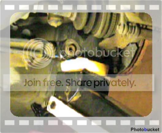

well said in the write up, my ball joint on the driver side will not come out, i posted this question before but i will try beating the lca with a hammer and see how it goes. tried prying, jacking it up and the bitch won't even move.
http://i63.photobucket.com/alb...1.jpg
prybar is on a jack. any ideas, methods?

ive never tried it. i always have good luck with just smacking the lca with a hammer. sometimes i heat it up with a propane torch. works every time

use a "pitman Tie Rod Seperator" its like a fork that grap then there's a middle part that you turn and it'll push the ball joint out. This is better because you wont ruin your ball joint. and for the axles if its to hard get a jack, and jack it up to support the axles so its parralle(SP) to the tranny and use a piece of wood and place it between the axles and your hammer and start tapping it in.
Old Jul 9, 2006 | 08:12 PM
integra3586's Avatar
Posts: 1,909
From: usa
Default Re: (RJonathan)
just be careful when using this method. it can actually mushroom the threads on a ball joint
