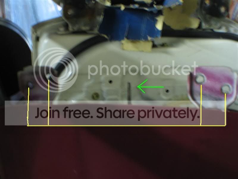

Would it be easier to just unbolt the whole door off and line it up again, or are there any specific bolts that I could just loosen up to adjust the height of my driver side door. I noticed that the trim don't line up right, and door is loose. thanks

Get a friend to help you out. Just mess with the four bolts that the yellow lines lead to. If you want to remove the door as well than you have to remove the pin that the green arrow is pointing at but there is no reason to remove the door just to adjust it.

great, thanks for the visual

My drivers door seems to sag just a hair. This will help. Thanks!
