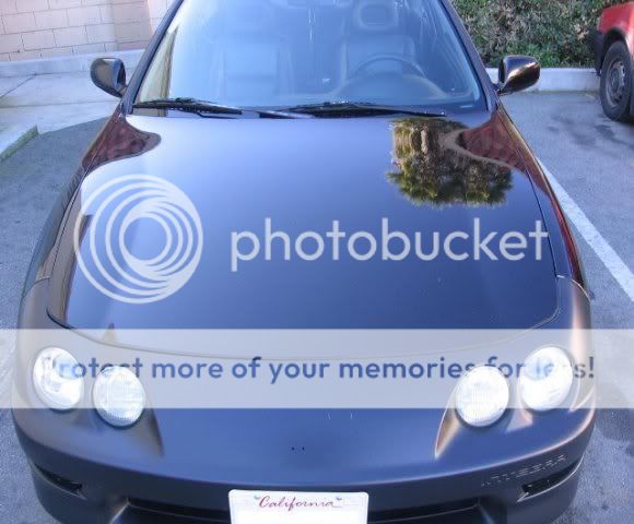

i just did a 98 front end conversion and every thing is going well except im puting on the turn signals. the 95 brackets are not fitting on my 98 turn signals. the brackets seem like they will fit on the bumper but the hole is too low. is it my bumper or do i need 98 brackets? Thanks

Yes, you'll need 98+ corner light brackets.

The reason is because the bumper usually comes with the brackets.

u will need the 98-01 bumper brackets. i did the same swap on mine and i temporary modified the 95 one until the 98 ones came in. i ent through honda to get them they were like 70

its simply the 98 integra front bumper. will fit on any 94 and up chassis. it just makes the car look new. you need 98 and up head lights and turn signals
